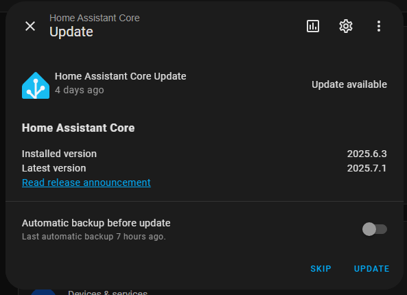

If you update from the UI it will say this:
These are not the same things. Like the OP posted that he updated from the UI.
