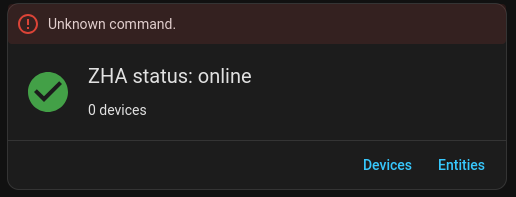

Updated SLZB-06 Zigbee Coordinator via HA and now it shows "Unknown command" and 0 devices
Settings > Zigbee shows ZHA Status: online but the error Unknown Command is shown above it and it says there are 0 devices.

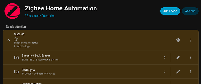

Settings > Devices & Services > Zigbee Home Automation says Failed setup, will retry but it does correctly list all 37 devices. Clicking reload results in the same error message.
If I click the gear icon I get this message asking me to backup and Reconfigure ZHA, but I figured I’d ask here if that was the best thing to do before I did it.
