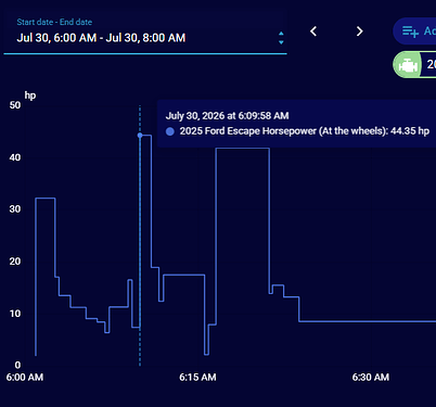

  • :toolbox: Metadata for 151+ known telemetry fields, including common OBD-II, GPS, trip, and manufacturer-specific values
  • :world_map: Location telemetry, including latitude, longitude, altitude, and bearing when enabled in Torque

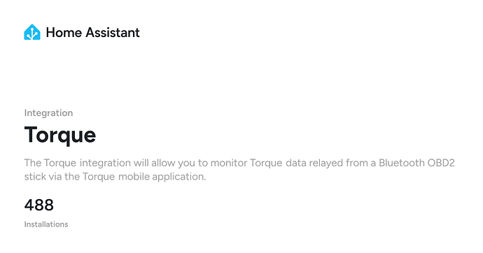

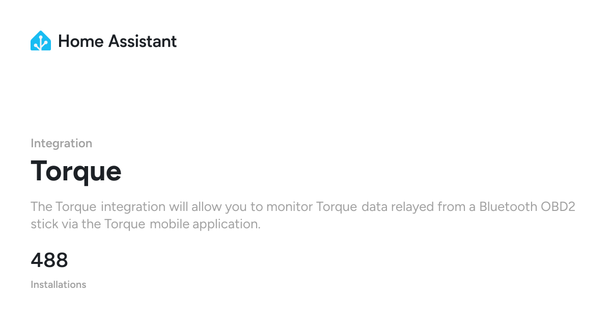

1: How is this superior to the other one offered directly by HomeAssistant? I see the original one is very popular, classified as Legacy, but updated only three months ago.
The Torque integration was introduced in Home Assistant 0.10, and it's used by 488 active installations.

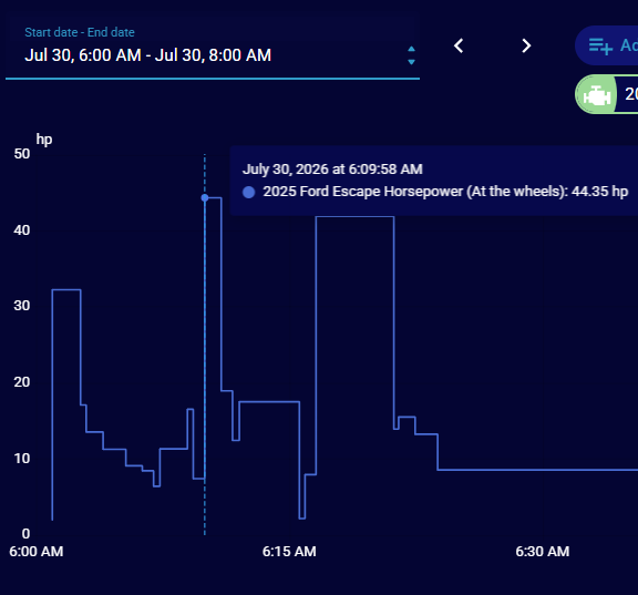

    As an example, I apparently managed to produce a mighty 44.35 horsepower on my commute this morning in my 1.5L three-cylinder.
