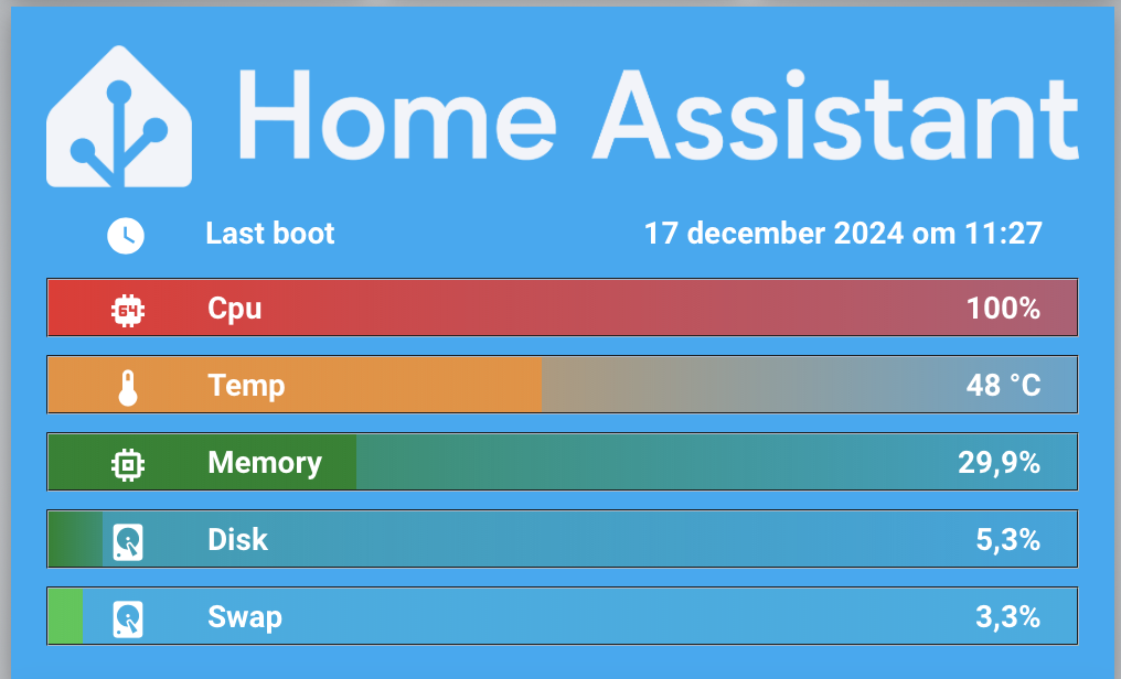

Updating ESPHomefrom 2024.12.0 to 2025.2.1
Why on earth is this happening… Considering the update should take place on the device (this is the Olimex POE), and not on the HA host itself, would this be a HA issue?
note this Not an an RPI2… it’s a miniPC with plenty of Memory and Disk as you can see, but it is overtasking the Celeron (admitted not the largest available…) processor.
Or, are we expecting this to be regular behavior. In which case I have to rewrite alerting automations to not be triggering an alert the updating ESPHome devices.
