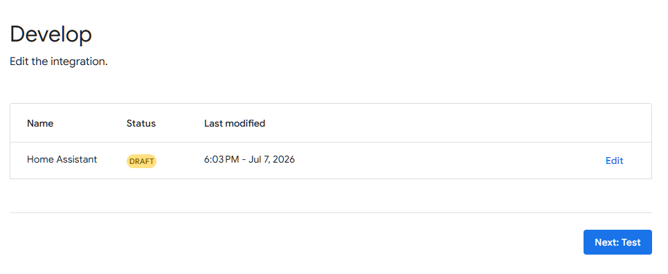

I went to update the Google Home.
Updated all the domain names
I saved but it is listed as draft
AI says I don't have to certify and deploy this. Is it true?

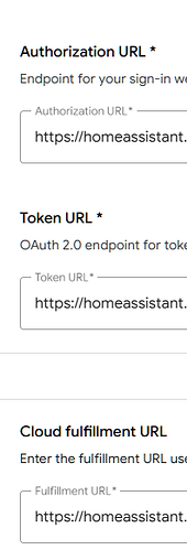

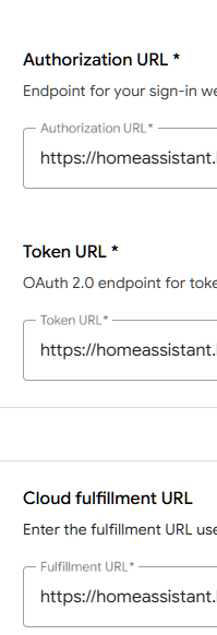

Neither am i, but you are aware that your " Url's in the screenshots are HTTPS
And all the urls you are trying to use (post here) Are using HTTP
