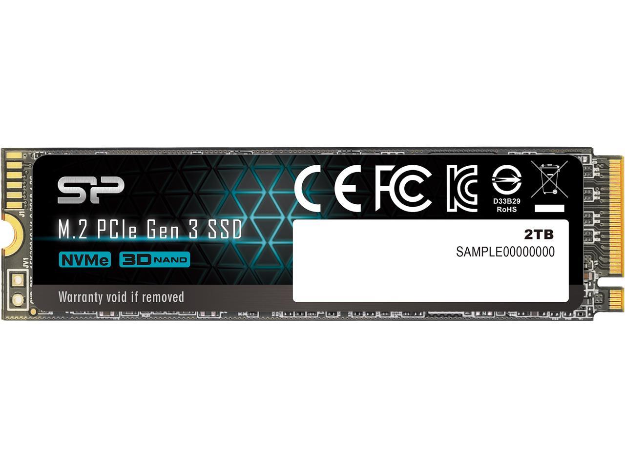

Assuming you were using only the storage on the Pi module, you can add a NVMe SSD to the Yellow and move your installation to that.
https://support.nabucasa.com/hc/en-us/articles/25549332241949-Adding-an-SSD-to-a-Yellow-with-an-existing-Home-Assistant-installation
When I setup my Yellow two years ago, I bought this one, and it's working great. You'll almost certainly never run out of storage:
Ooof though. It's three times more expensive today than when I bought it. Still, it's cheaper than buying a new device.
Thanks Kyle, yeah a bit above market price, but purchased and on the way. I don't argue with success, so the known compatibility is worth the premium.

Installed, easy, moved storage, easy, all is well! Thanks!
