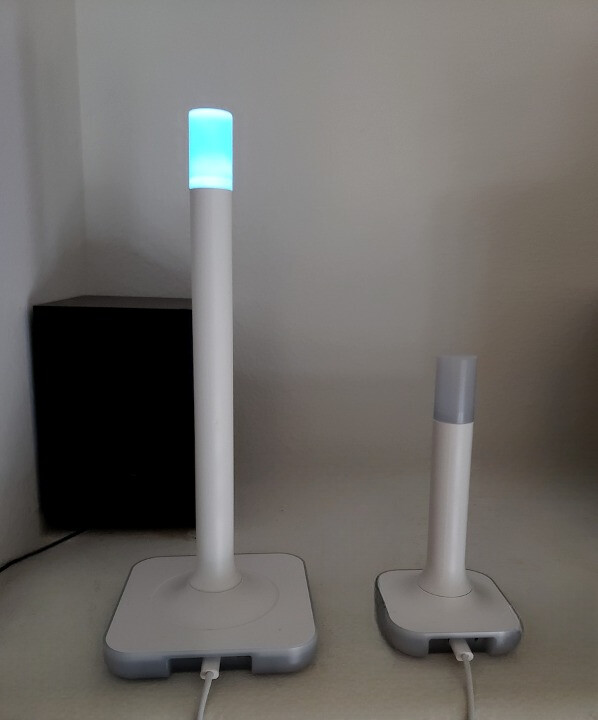

LED behavior
The ZWA-2 has its LED on during normal operation, while the ZBT-2 shows no LED when running. I initially thought my ZBT-2 might be defective until I confirmed that was normal.

I have both dongles standing side-by-side… one of them looks broken… (the ZHA doesnt have its LED on for some reason).
I’m about to do this - what directions did you follow? Thanks though for the LED thing, it would have bugged me if I didn’t know that info.

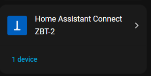

Both devices look pretty cool :sunglasses:
The only issues I noticed first are:
  1. ZBT-2 device doesn’t have its light turned on while it is in use (to match the ZWA-2).
  2. ZBT-2 device adds the below integration, but there isn’t an equivalent one for ZWA-2 yet.
