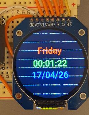

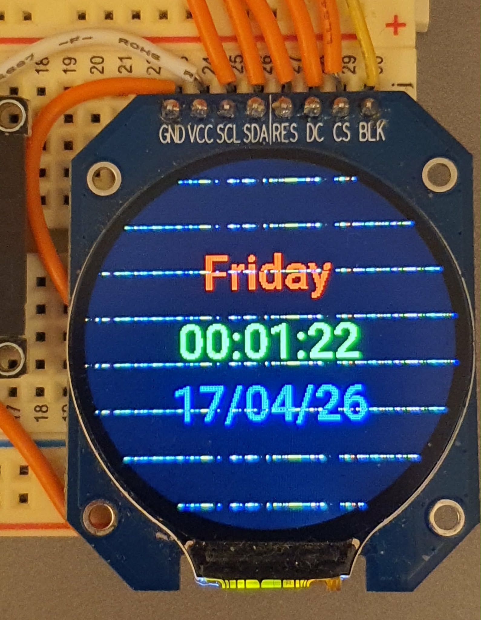

I have a GC9A01A display and simply changed the platform line from ili9xxx to mini_spi - this works but introduces horizontal lines on the screen…
display:
  - platform: mipi_spi
    model: GC9A01A
    cs_pin: GPIO10
    dc_pin: GPIO2
    reset_pin: GPIO1
    invert_colors: True
Does anybody know why this is happening?
