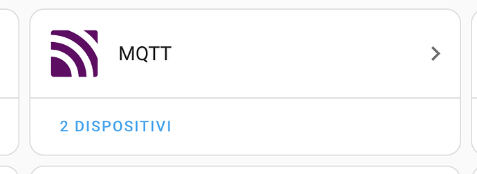

From zigbee2mqtt everything is working fine. But if I open the MQTT component I don’t see the entities I added after the upgrade…
there should be 7 devices… I’ve already tried many config changes but no luck…
