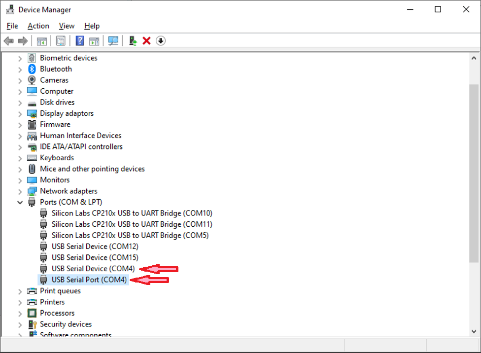

If you’re using windows: open device manager and open “ports (com&lpt)” tab. Then connect your esp device and a new COMx device should appear(name can be different than one on picture, com number is important). If it doesn’t then it’s something wrong with your esp (or usb to serial chip onboard). If com port shows then assing this one when comnecting via esphome web.
the device manager refreshes every 2.5 seconds when its plugged in, interestingly on a windows machine i can actually see the device in esp home web thing but it never has enough time to connect before it sh!ts its self again. and comes back with not connected.
This can happen if USB port is not powerful enough (or perhaps also bad usb cable?), and so esp keeps resetting itself because it doesn’t have enough power. Try to power esp module separately on quality 5V power source and then connect it to PC. If it doesn’t help it really can be bad uart–>usb chip.

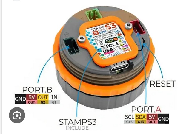

after some reading on the web I found that the physical Button on the back that is a circular arrow is not the reset button.
it is shown here in this image as reset, this is not the reset button
there is another button on the stamp itself. under the text “BTN0” this is the button you hold down while powering the unit on. here is a pic taken from a video on the m5stack site of someone pressing it with their fingernail
so now i can move code to the device with no errors, it still does nothing on the screen, but i think maybe all the code i can find is for the stamp S3, and the unit I have is a stamp S3A
Yes, i also got to similar when button on the shelly wasn’t gpio0… and, as said, some usb chips can automatically set esp into bootloader mode when sending upload command, but not all, on some of them you must do that manually (like yours, for example).
