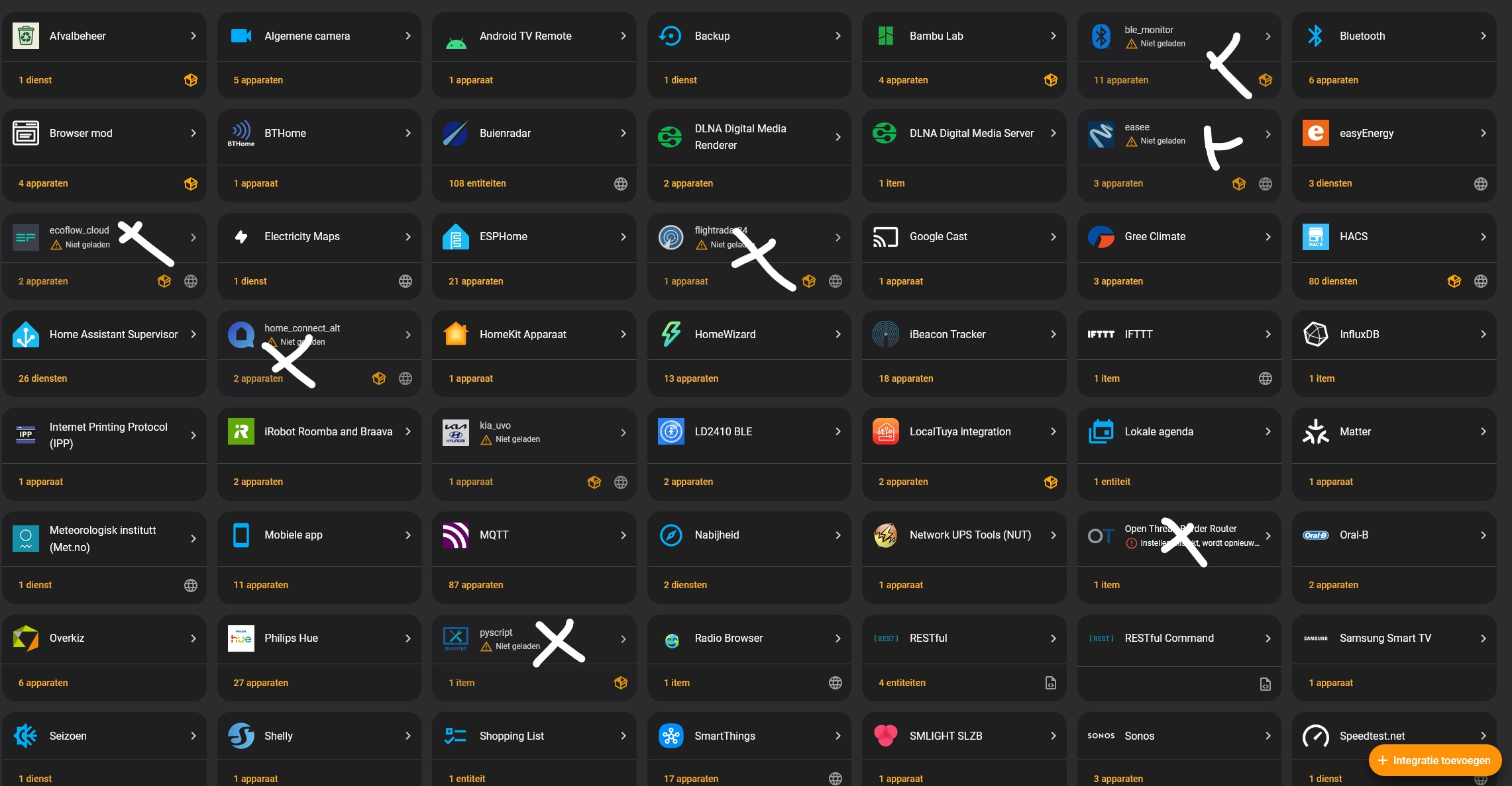

Check your logs - in my case, https://wheels.home-assistant.io is down so various packages are failing to install for HACS integrations.
Edit: Confirmed - https://wheels.home-assistant.io/musllinux-index is down · Issue #1084 · home-assistant/wheels · GitHub

ok, so mine started working again, waited and did nothing, once it completed I noticed that 2026.7 was still showing not installed, I pressed install, it restarted and all good. Only thing I noticed is that integration icons are not there.
Ok, now integration icons are back, it looks like a very slow upgrade.
