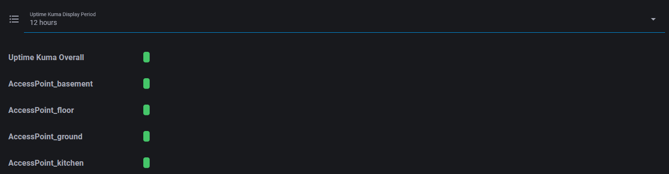

Here is the actual outcome. The first picture show how it should look like (number of bars configured manually (12h, 48 bars):

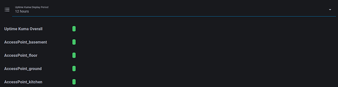

And here the same selection but done with template card variable (again 12h, 48 bars):
So it seems that uptime card accepts to some extend config template variable to calculate width of the bar, but does nto diaplays all the bars correctly.
Anyone faced something similar? Is it uptime card bug or am I doing something wrong? Any other idea how this could be achieved?

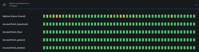

OK, figured it out. Seems custom template card provides value of variable as string (even if this is number) and uptime card does not accept string as input to bar: amount attribute. So modyfying variable to be converted to number prior to providing its valuie to uptime card solved the prblem and now I have dynamic number of data points.
Here is modyfied code, in case someone find it usefull:
