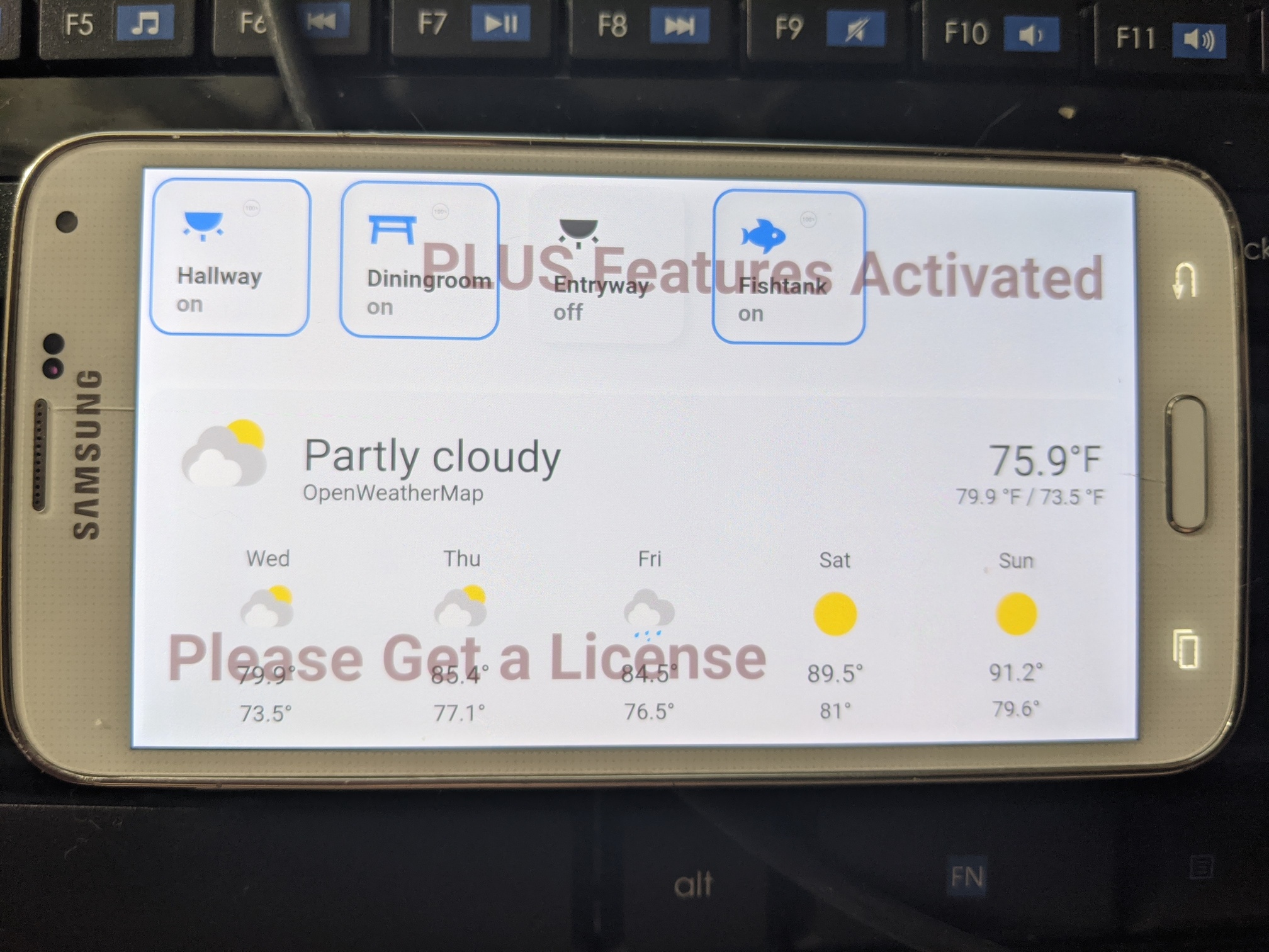

Just a quick update on what I have going so far.
I have this running in File Kiosk Browser on am old Galaxy S5. I plan on mounting it directly above the double light switch for my dining room and hallway leading to kids bedrooms. It also controls the light for our entryway that leads into dining room and the light for the fishtank in the dining room. I had a black space so I figured that was a good place for the weather forecast until something better presents itself.
