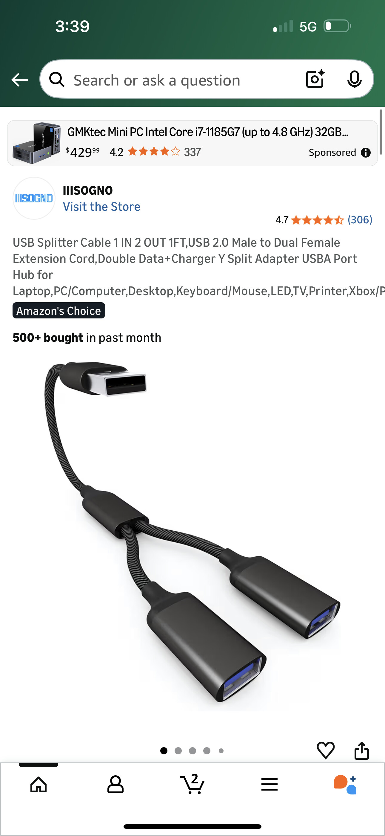

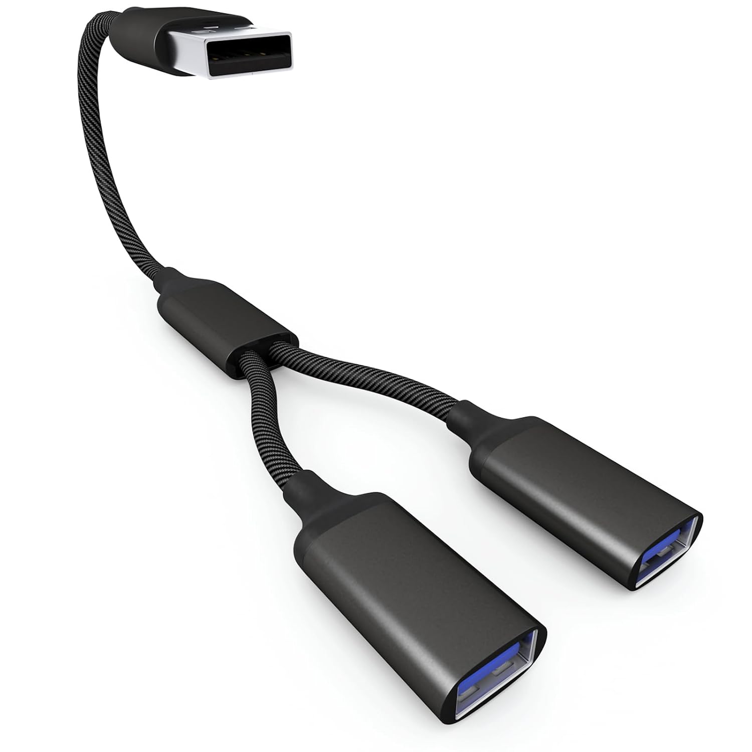

Learning as I go to get home assistant running. So I came across that we need to use a usb 2.0 extender to avoid interference from usb 3.0. Question that I have is that ok to use a cable split to use both zigbee and zwave? Something like this:
I’m running on mini pc so I have limited usb ports using something like that would be nice.

The question I have that I couldn’t find yet is if I can use one cave for both Dongles zigbee and zwave without interference.
ChatGPT tells me it’s ok, but I don’t always trust it
This video tells me otherwise where the guy was having issue where his pc wouldn’t even boot because of the hub: https://youtu.be/xF5SDzgj2rU?si=O1BkxEMGahInTpKg jump to 3:20 minutes
