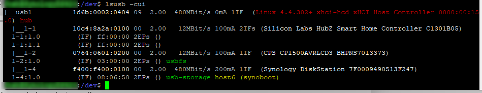

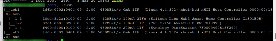

An lsusb command on the Synology shows the USB is still there:

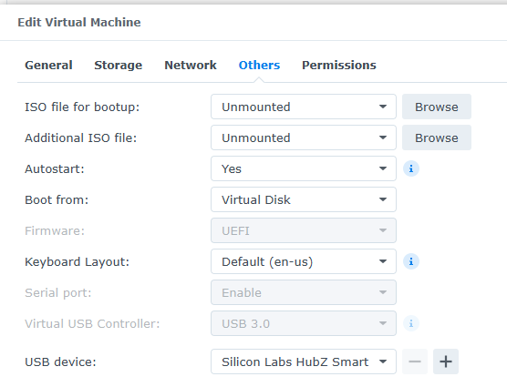

The VM also still has access to it:

I recorded my device path some years ago as:
/dev/serial/by-id/usb-Silicon_Labs_HubZ_Smart_Home_Controller_C1301B05-if00-port0
...however, that's no longer available. Any help would be appreciated.
EDIT: I'm getting the feeling that a Synology update wiped my device drivers... so I'm looking into that.
EDIT 2: The device is here... but no device path. This is my problem. I don't know how to get this back:
EDIT 3: OK, progress... though, my integrations are still down:
