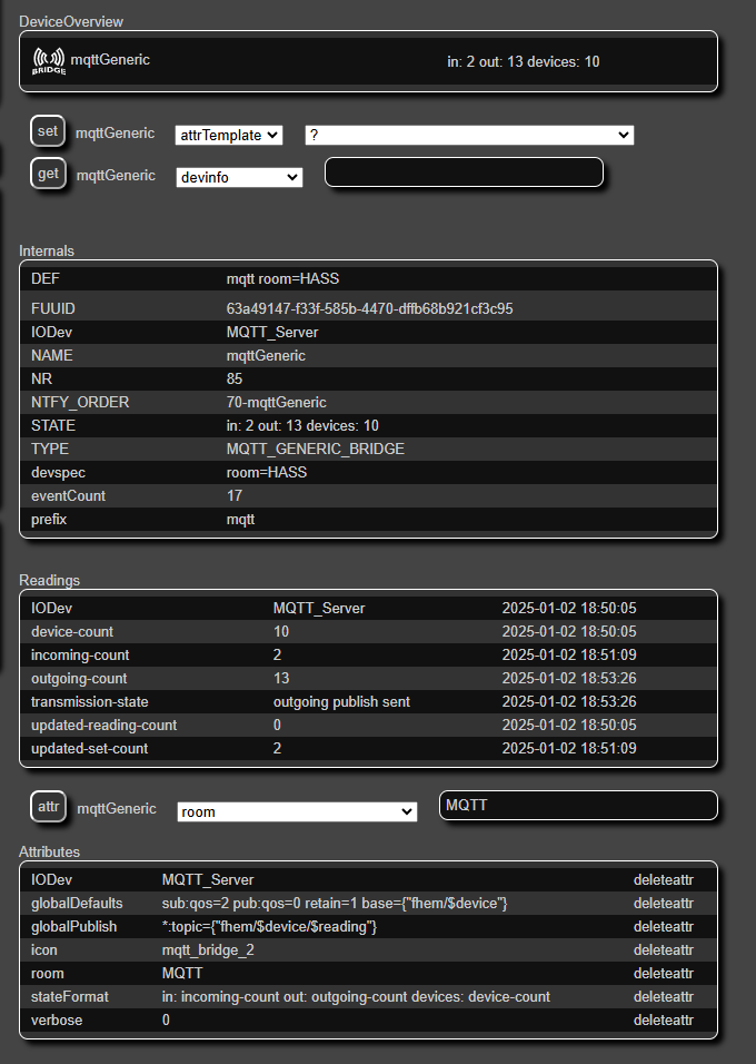

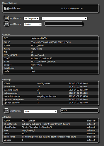

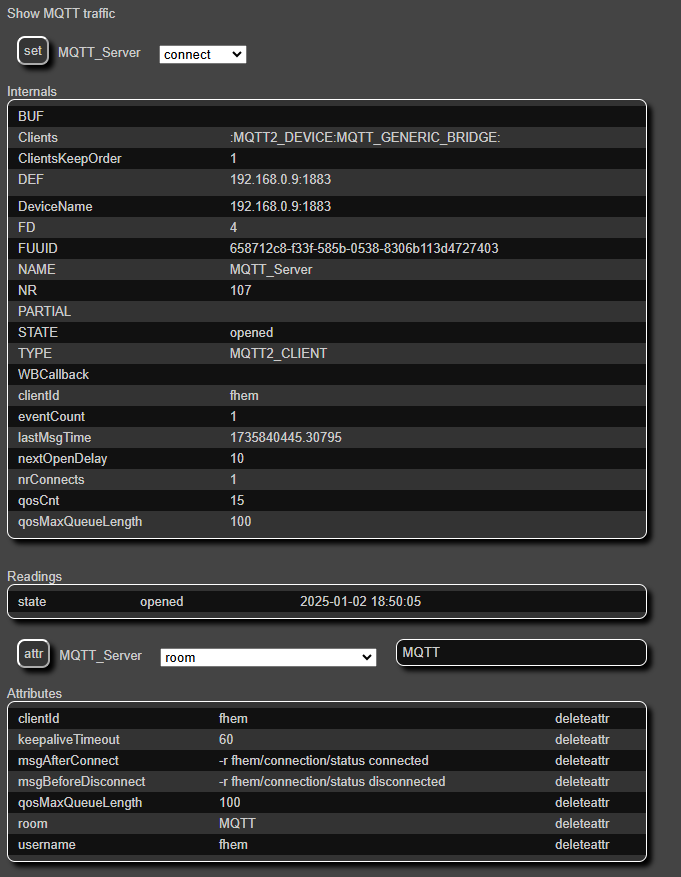

What I do now is, to “sync” between HA and FHEM with MQTT.
this way I do not need to touch fhem to control my 433mhz devices, like Somfy RTS Shutters and plugs in fhem, but can do everything in HA.
As a workaround it’s ok, but I would like to get rid of fhem one day, but first I need to solve my 433mhz-cul problem.
How do you do the synchronising between fhem an HA? Could you share more Details of how to do it via mqtt? Thanks
I googled a bit for possible solutions and played around with MQTT and a bridge then.
with that i got it working.
