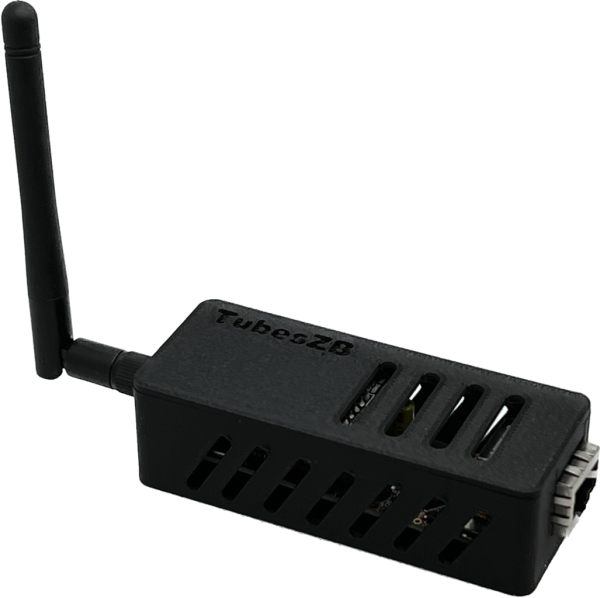

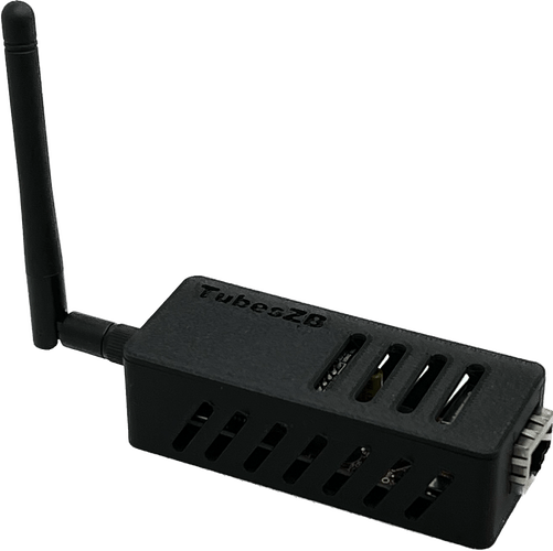

Your best option in this case would be to get a “hybrid” coordinator & migrate all your devices to it. Something like the SLZB06 from SMlight or the Dongle M from Sonoff should do.
Mine is a pre-purchase investigation. Home assistant runs on Rpi but for convenience and reception I would like to place the zigbee coordinator in the center of the house.
In light of this, which model would you recommend? If necessary, I can connect it with both WiFi or POE.

They are build to order so you might have to wait a couple of days.
