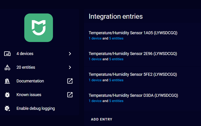

Can you add the devices in Xiaomi BLE integrations rather than having to name them in ESPhome so both bleproxies can pass the info back to HA as the same name.
