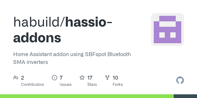

I did a quick Google search on your model number and ‘homeassistant’ and got a quick hit.
Have you looked at the SBFSpot Hassio add-on?
