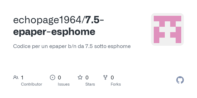

I solved in this way:

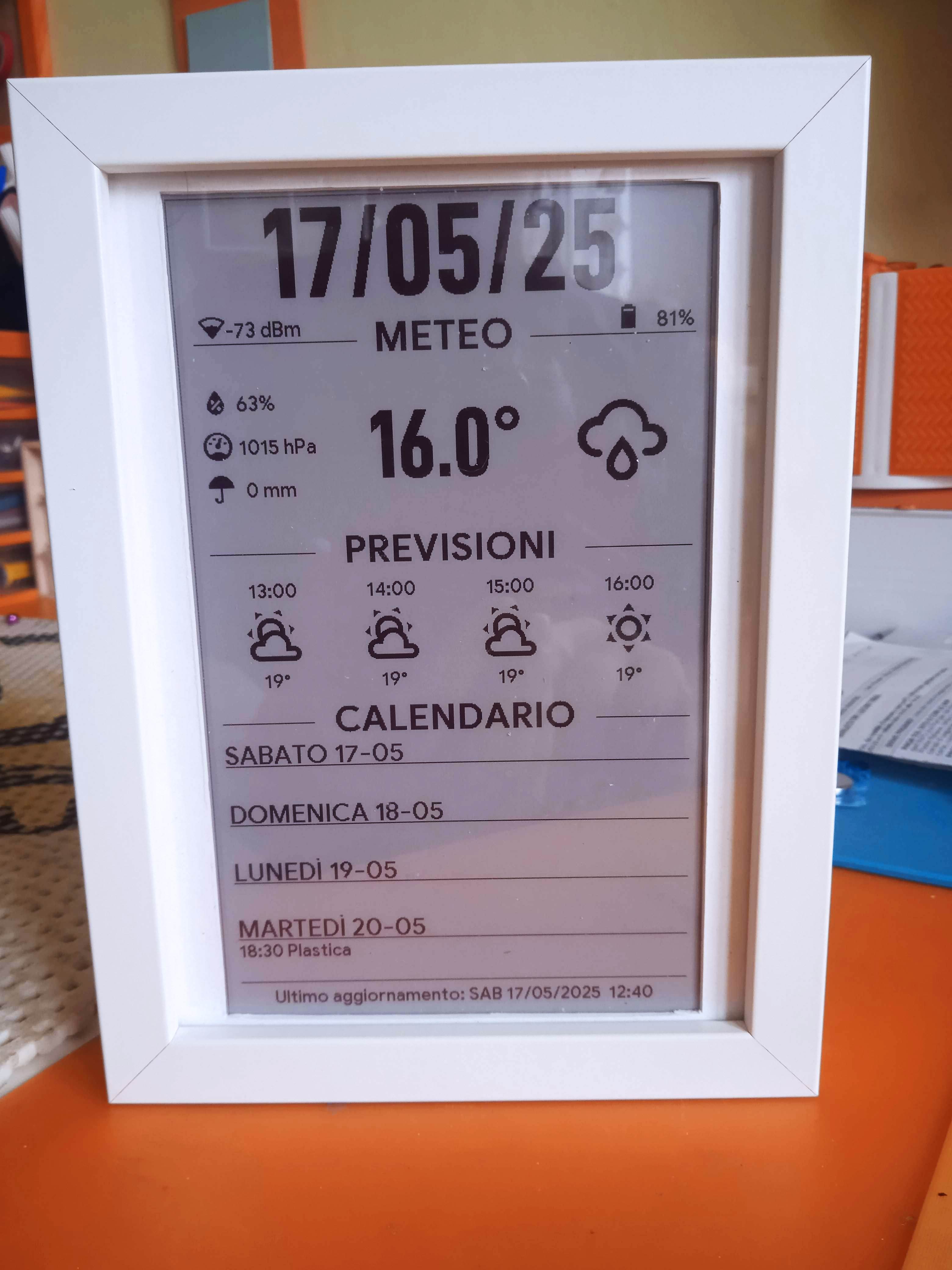

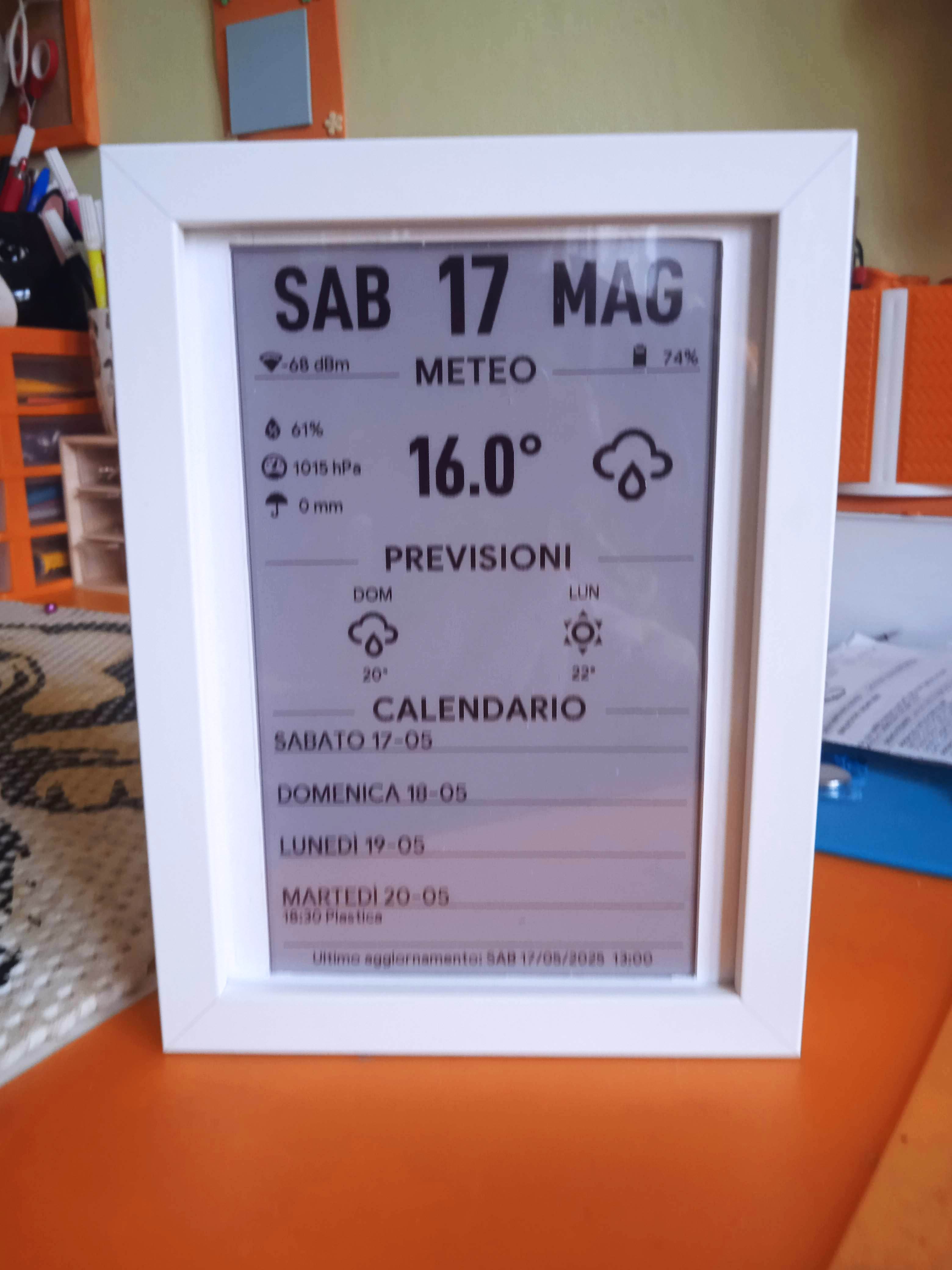

Finally, thanks to your examples, I managed to finish my little project. And I wanted to share it with you!
Many thanks for the inspiration, not only do I have a useful display, I also learned a lot.
Here is my take on your idea:

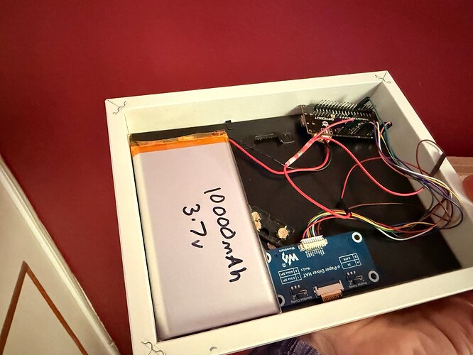

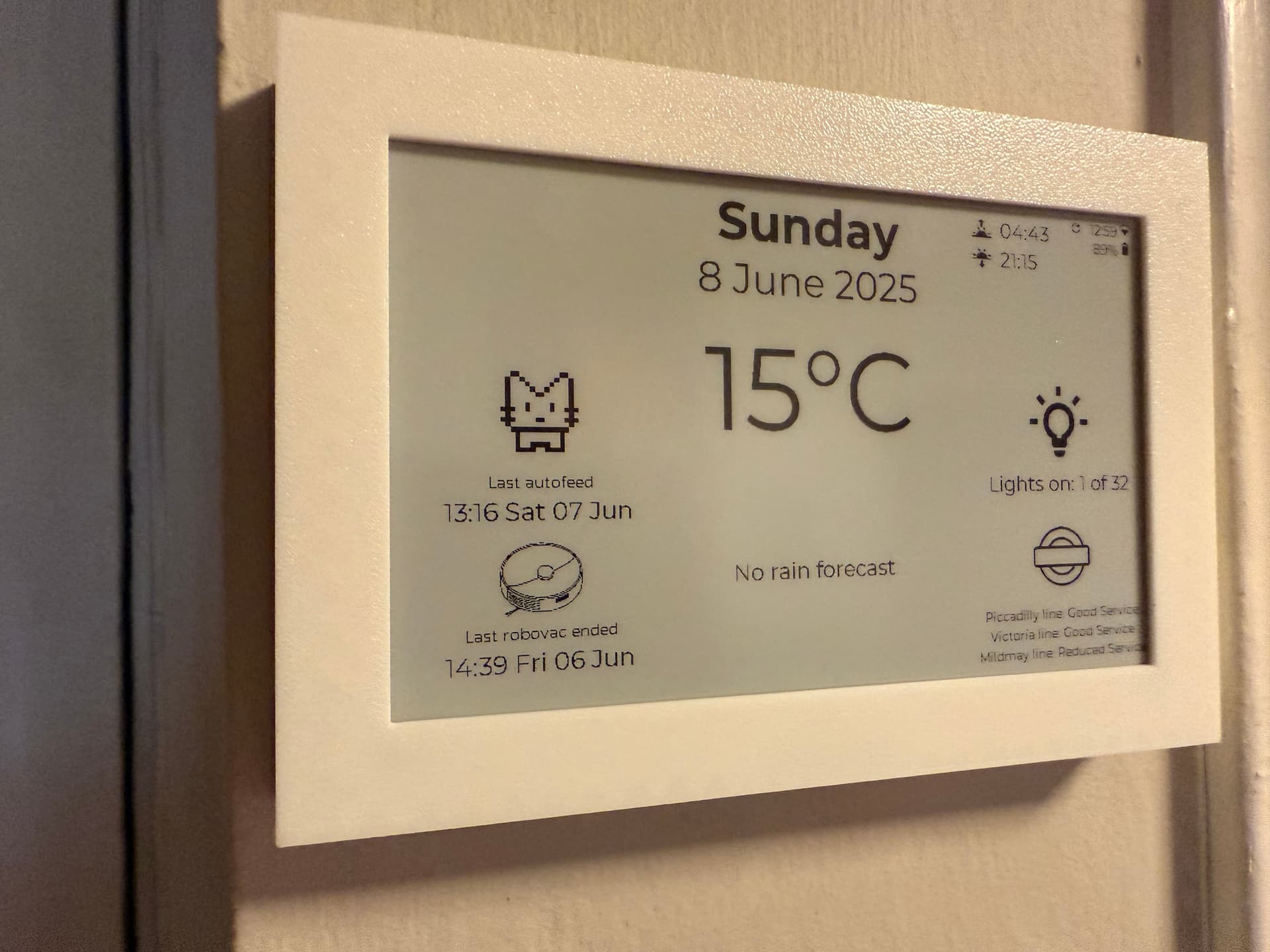

Here’s my latest project, a portable home dashboard, mainly designed to show a giant umbrella icon when rain is due so I can take my bike jacket (not shown).
This is a Waveshare 7.5" ePaper (black and white) powered by a Firebeetle2 ESP32-C6 and a 10000mAH battery, inside a 3D printed case. It shows the status of my Aqara pet feeder, Roborock vac, lights, and local transport. As well as local sunrise/sunset, battery and wifi levels.

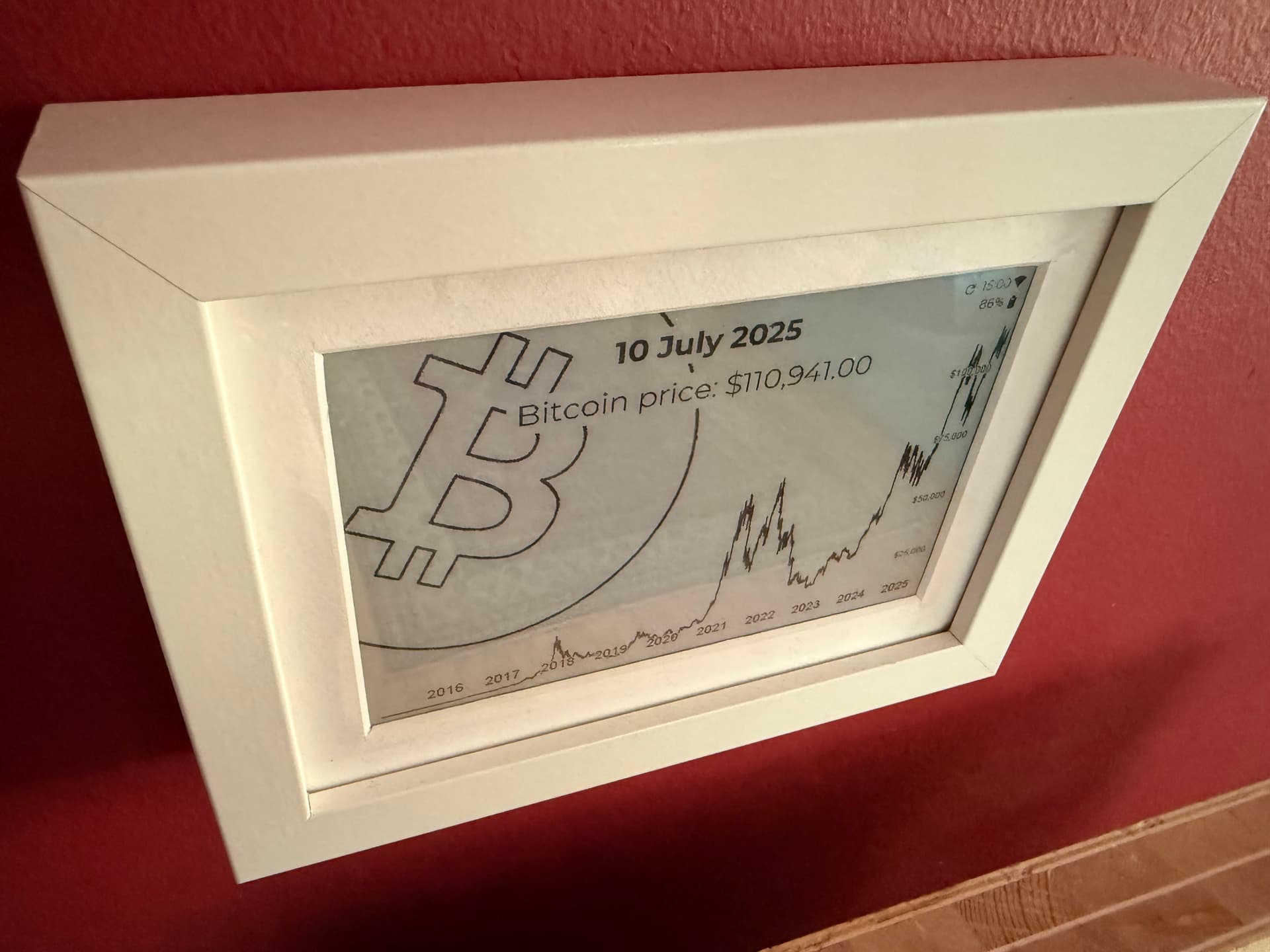

Here’s my revised Bitcoin charting display based on the same platform (in IKEA frame), front and back:
If anyone wants my config (almost entirely rewritten and remodelled) or more photos, let me know :pray:

Hi PharkieB,
First of all, this looks very nice! I was going for the same setup with the Firebeetle 2.
Could you share some images/information on how the jumper wires are connected from the HAT to the Firebeetle? And if it’s not too much asked, i’d like to see the config as well.
Thanks! :pray:
Ah sure, sorry for the delay, I wasn’t notified about your reply. Welcome to the forums, cheukkie, and thank you!
The pins I use (others could work too):
  clk_pin: 4
  mosi_pin: 6 # DIN
  cs_pin: 7
  dc_pin: 1
  busy_pin: 3 (inverted!)
  reset_pin: 2
I’ve put the files up on a gist:
(main config is loooooong)
That should get you going, and if you have questions about it just let me know.
