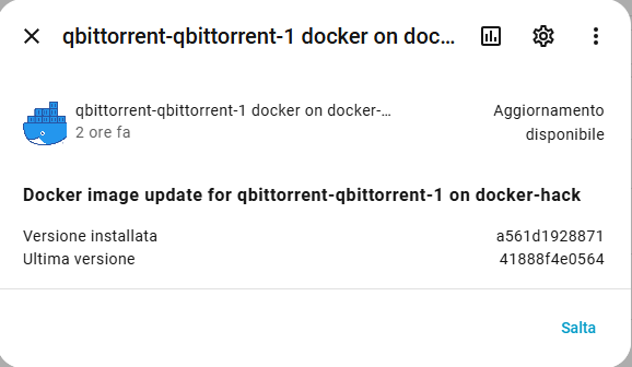

Ok this is my fault :slight_smile:
I see single entities created in mqtt, but i expected to find the “hosts” themselves, that is not the case
So now my issue is understanding why this
was not shown to me anywhere if not going to take it specifically:)

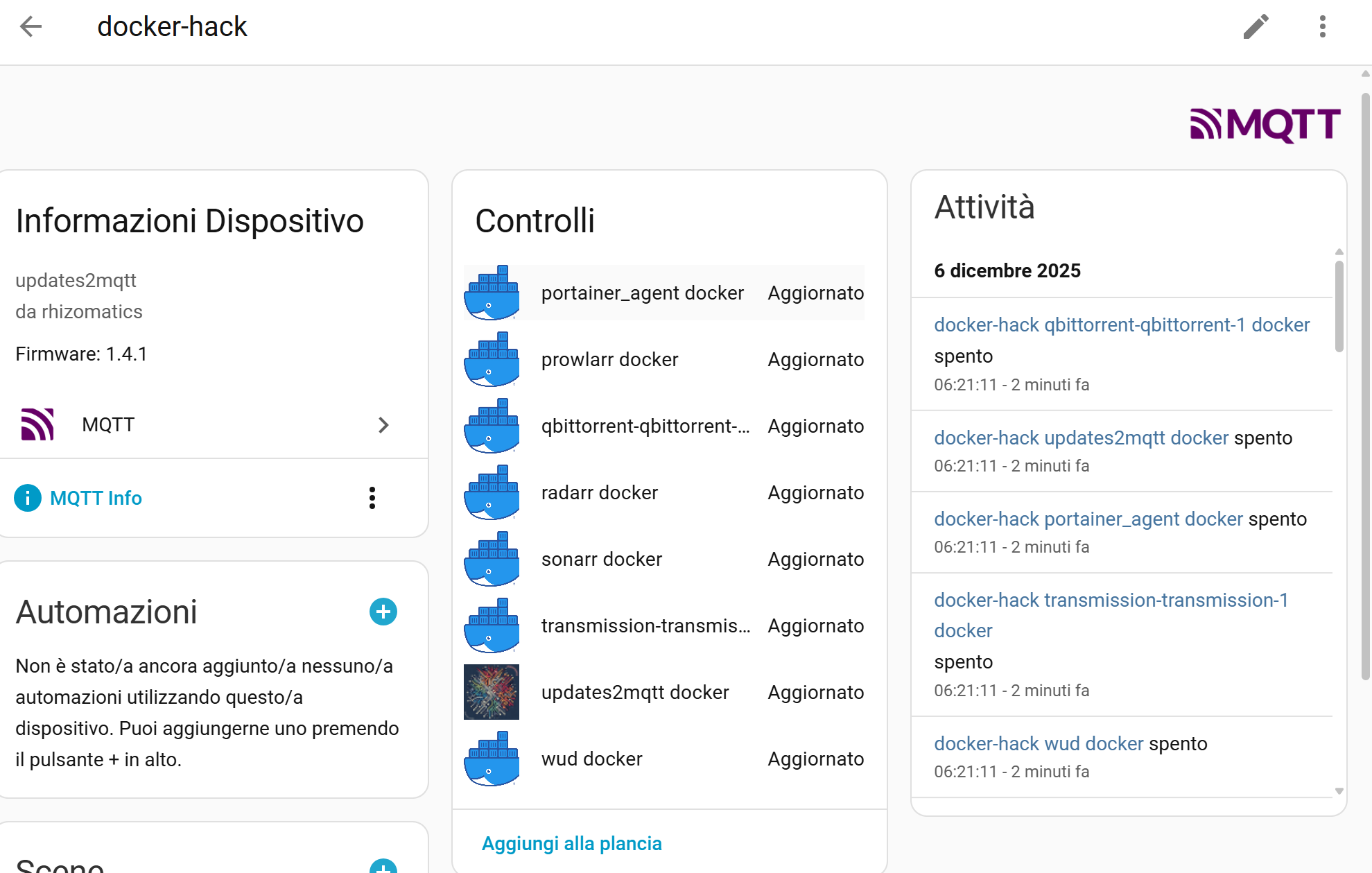

this seems to be far easier than expected. If in the discovery of entities you add a device block in the json, HA joins all entities under the device. In our case, the device could be the server, listing the update entities for all containers. Makes a lot of sense. It should be enough something as easy as
"device": {
  "identifiers": ["my_docker_server_identifier"],
  "name": "My Docker Server",
  "manufacturer": "rhizomatics",
  "model": "Docker Containers Monitor",
  "sw_version": "1.4.1"

and it is very nice to see :slight_smile:
