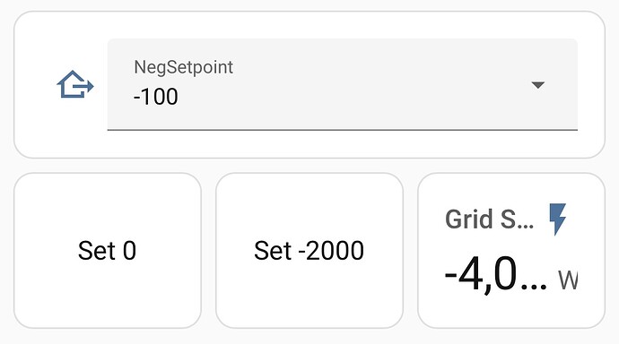

On my Victron inverter (already integrated into HA), I can set the grid setpoint to control how much energy I want to export (i.e. 0, -1000, -2000 watts etc). On my dashboard I have some ‘hard coded’ button values which calls an automation which sets the value, this works fine but I will have loads of buttons for each negative setpoint, and want I really want is a drop-down box (input_select) to choose a value and then click a‘Set’ button. I’ve created a selection helper (NegSetpoint) with my values but I can can’t figure out how to use the selected value in my automation?

Hi tom, thanks for you reply. My thinking is rather than having a separate button for each individual setpoint, I instead choose from the drop-down help and then hit ‘Set’ button. This way I only have 2 controls on my dashboard to set the setpoint.
Looking at your yaml above, I can’t see how that runs the action to set the negative setpoint on the inverter. The iPhone notification is just in my yaml as a test to see if I could get the value my input_select help.
