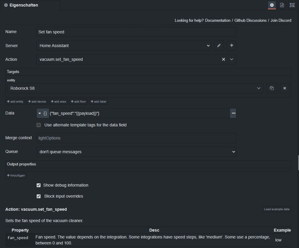

thanks for your support. I slightly adapted it while using Node Red
