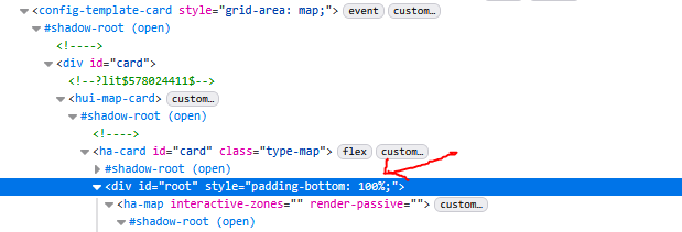

I don’t think the CTC card is the issue other than it steals the styling from the map card under it. When I check it out with Code Inspector, the config-template-card element takes up the entire remaining area of the screen like I suspected. It’s the map card rendered under it that is no longer styled to fully fill the CTC container.
I have an idea for a possible fix. It’s a bit hacky and dumb, but so is HA in general so it’ll fit right in if it works.
If I change this to ~150% it makes it look the way I want it to. I don’t think that’s card-mod friendly though

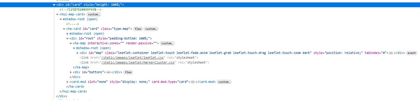

It is. This PR will fix it in a forthcoming release: fix: card's height in horizontal-stack & grid by ildar170975 · Pull Request #158 · iantrich/config-template-card · GitHub
The “div#card” should be altered, not “:host”. That was my PR, and I have forgotten a proper way to fix it; checked my PR and it turned to be that “div#card” element.
To manually fix it - try doing these steps:
  • find a folder with a JS file
  • delete gz file
  • open JS file in editor
  • paste “style=“height: 100%;” into a proper place (check the PR for an exact place)
Ah, right you are. Manually editing in the PR in dev tools fixed it:
I’ll see if I can patch it in the js file until the update comes out.
Thanks!
