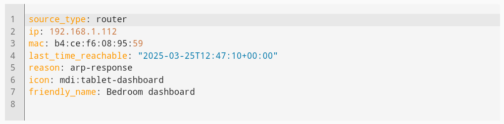

I need time item in yellow block

My Nmap entities have a “last time reachable” attribute, is that any help?
