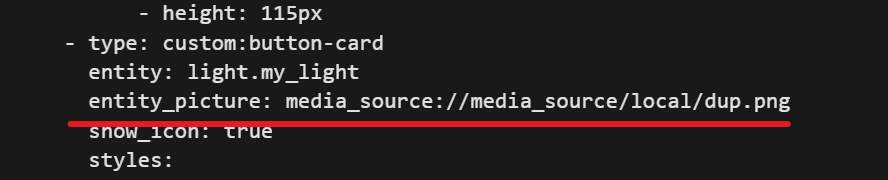

              - type: custom:button-card
                entity: light.my_light
                entity_picture: media_source://media_source/local/dup.png
                show_icon: true
                styles:
                  card:
                    - width: 115px
                    - height: 115px
                  icon:
                    - width: 115px
                    - height: 115px

How to I just add things from my Media which I uploaded to this dashboard? It doesn’t show up even if I directly open the picture and use the link and paste it in. What am I doing wrong here?
It’s called dup.png, so I put /local/dup.png

EDIT…just saw your button card code is incorrect for entity_picture: here
The correct format
show_entity_picture: true
entity_picture:  /local/xxxx.png

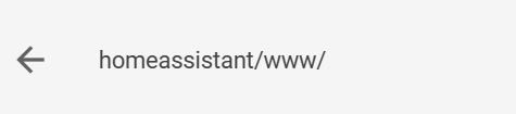

Yes. Changed it to show_entity_picture too. Nothing is available from the www folder. I even just put the same png files in there. It’s not available. How would someone access something from the www folder from the external Internet? Or just internally at least. Idk what I did wrong. I added media to my config too.
Do I need to somehow enable the http server in config?
When you are in your file editor, what happens when you click on the png file?
It says 401 unauthorized. Huh. I assumed it would display the picture. I uploaded it via file editor.

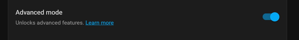

  2. Is your user set to Advanced Mode?
http:
  use_x_forwarded_for: true
  trusted_proxies:
     - 172.30.33.0/24
It’s setup using https. It has a letsencrypt certificate and doesn’t use http unsecure to my knowledge. And yes it’s in advanced mode.
