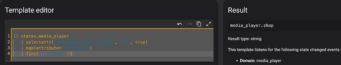

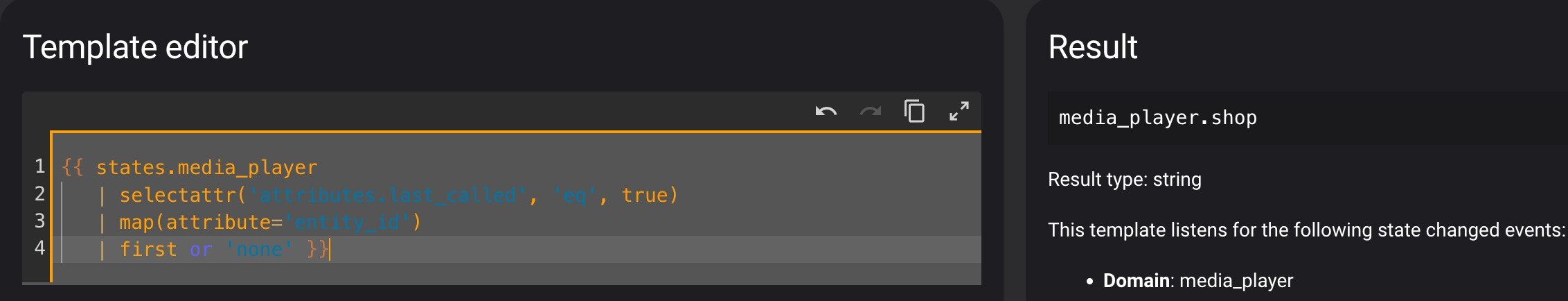

You also have to create this template sensor:
{{ states.media_player
   | selectattr('attributes.last_called', 'eq', true)
   | map(attribute='entity_id')
   | first or 'none' }}
Sure enough, the ouput from that template sensor shows which device got the last command.

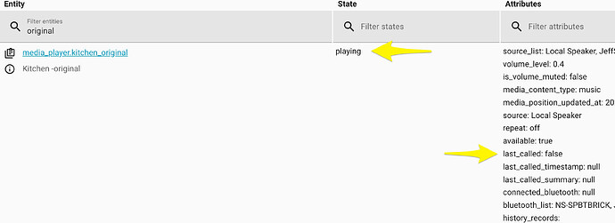

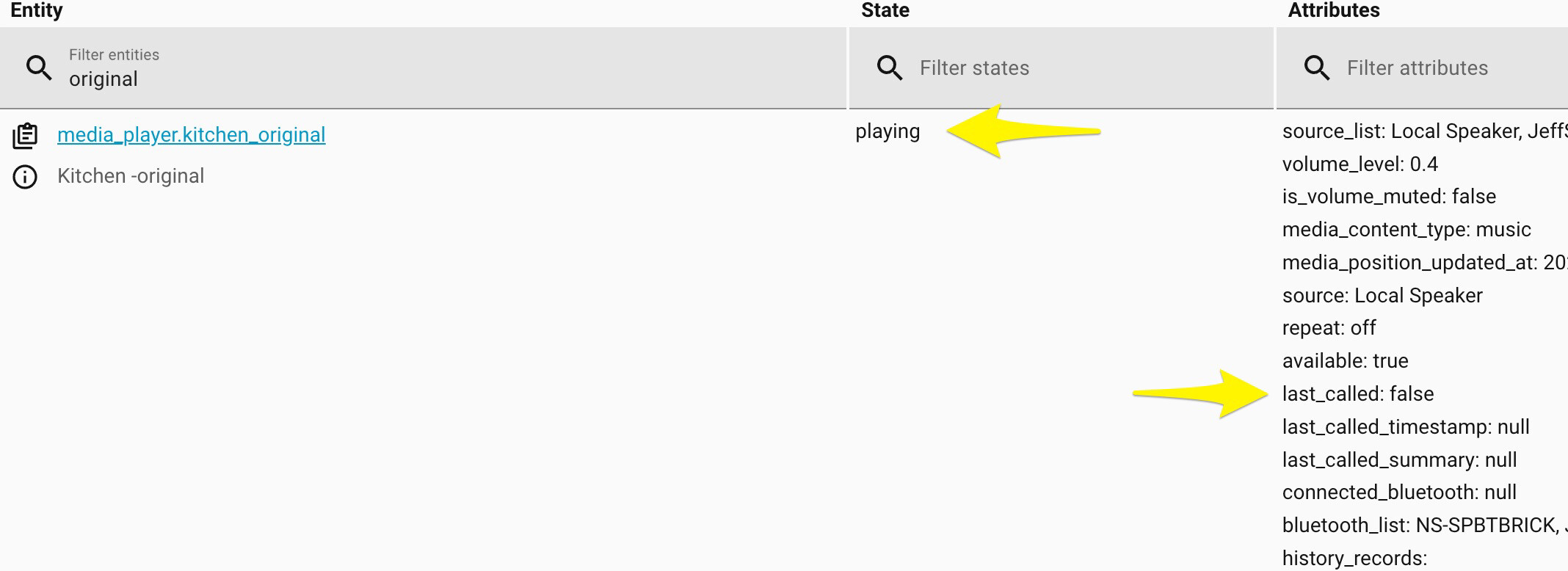

Now, IF ONLY that attribute would frigging update.
“Speak a simple command to one Echo (e.g., “Alexa, what time is it?”).
Immediately call alexa_media.update_last_called in Services (add data if multi-account: {“email”: [“[email protected]”]}).”
Calling that service has no effect. I can see the state of the Alexa change from Playing to Paused, but the last_called remains static.
This sure would be elegant (AND SIMPLE) if it worked. I wonder if it’s a bug in the integration or just Amazon being Amazon.
