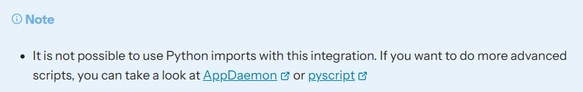

https://www.home-assistant.io/integrations/python_script/
