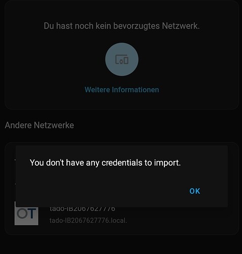

I have a problem with using a tado bridge X as a thread border router for other thread devices (namely Aquara W100). I always get the error, that I need a thread border router, although I have the bridge X in the same network.
After adding the bridge to the network, HA found it and added the Thread integration, where I can see the Tado bridge under “Other networks”.
I’ve tried to sync the credentials, but I always get the error, that there are no credentials to share.
I get a similar error, when I try to sync from the “Troubleshooting” menu (sadly I can only add one media attachement).

I have exactly the same issue

As you can see I was able to do it less than a year ago.
I joined 3 Aqara Thread sensors to the Tado Bridge X network, and then I set them in Alexa. Completely working.
BUT now I had to reset one of them and I am no more able to join this sensor.
Just for testing I shared the two still working sensors from Alexa to HA via Matter code generated in Alexa, and they connected to HA (see screen).
So it seems that at the beginning sensors joined Tado Thread network, now they have credentials so still join, BUT new joining is not working as same experience you are having.
I suppose Tado changed something. It’s unbelivable.
