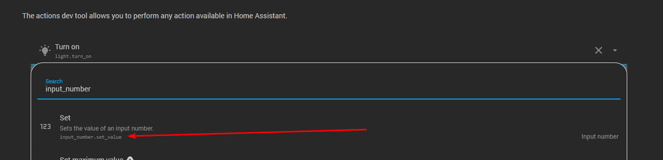

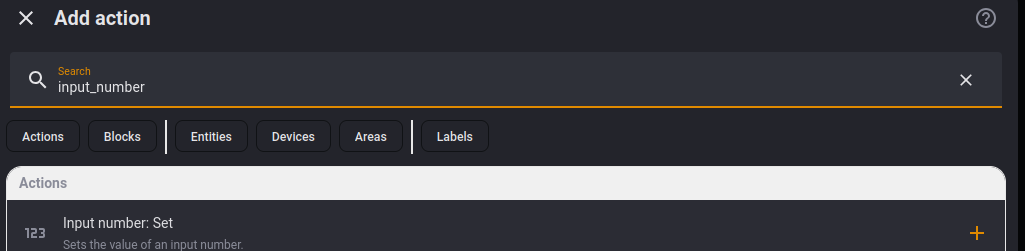

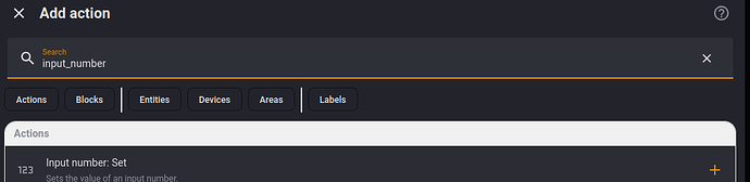

that service is available only in yml? Because I don’t see such block.
It’s not a block, it’s an action. And you need to create the input_number first.
ok, I see it. Trying to add it into my script.
