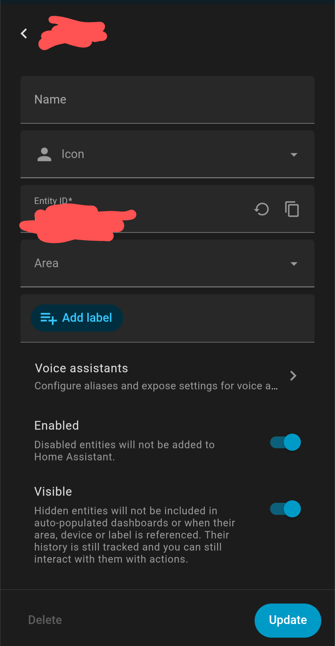

So I have been following this, and just assumed it had been something in 2025.12 or bug to be fixed. All my tracker automations worked fine, and pinging the entity showed recent updates. For me, I go to the map tab, top right search entity and search the user name associated with the tracker. For some reason, these are no longer set to “visible” as previously. Toggling this on has fixed my issue and map works as it did last month.

i’ve always have the person entity set to not visible, but previously this didn’t affect it map display.
making it visible does make it appear on the map, but also makes it appear on the overview dashboard, which is not required.

this solves the problem for now.
