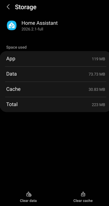

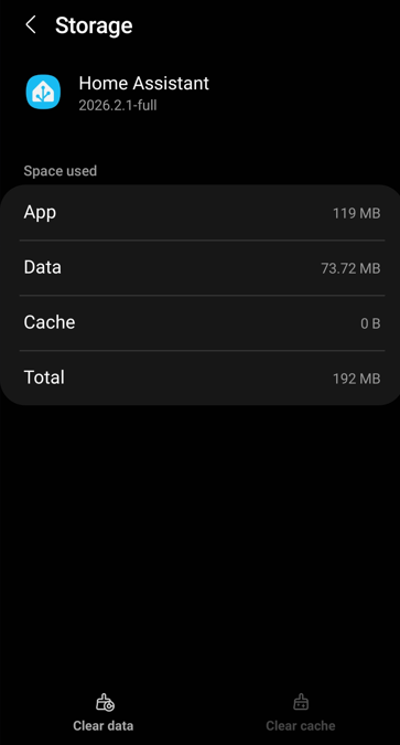

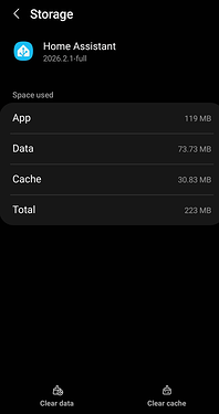

me too… it turns out that there is a right way and a wrong to clear the cache.
My first/failed attempt was,
from Android Settings → Apps → Home Assistant → Storage → Clear Cache
Before Cache Cleared:
Cache CLEARED:
