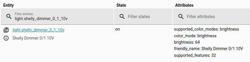

Hi. I have a Sunricher ZG2835 knob dimmer which I would like to use to control a Shelly Dimmer 0/1-10V PM Gen3 (entity type Light, dimmable).

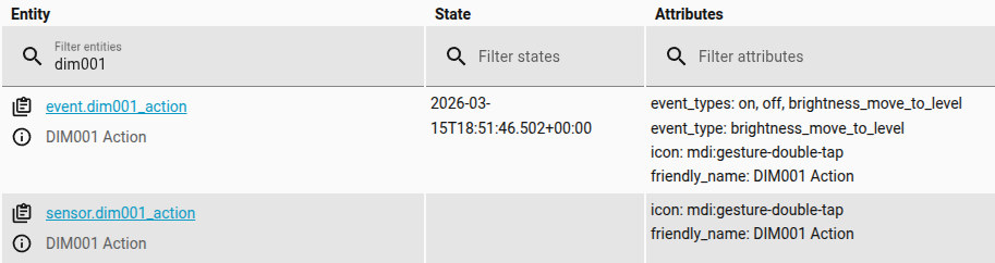

In HA under the Sunricher knob it exposes an event named “Action” (event.dim001_action):
… however under Zigbee2MQTT I can see a few others under state:
