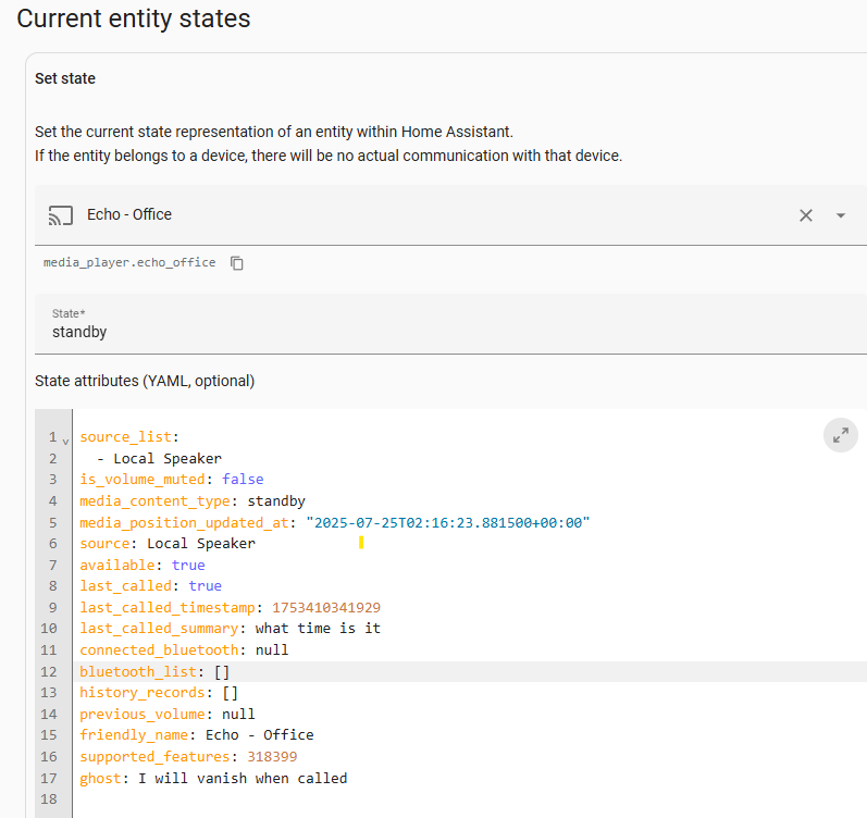

  alias: last_called_echo
  description: Setzt input_text.last_called_echo auf das zuletzt angesprochene Alexa-Gerät
  trigger:
    - platform: homeassistant
      event: start
    - platform: state
      entity_id:
        - media_player.kuche
        - media_player.wohnzimmer
        - media_player.bad_joerg
        - media_player.office
        - media_player.fitnessraum
        - media_player.gastezimmer
        - media_player.bad_yvonne
        - media_player.schlafzimmer
      attribute: ghost
      from: "I will vanish when called"
  condition: []
  action:
    - choose:
        # Fall: Attribut ghost wurde durch Aufruf gelöscht → Gerät wurde zuletzt angesprochen
        - conditions:
            - condition: template
              value_template: '{{ trigger.platform == "state" }}'

Can anyone provide a little additional guidance on how to incorporate the R2D2 ghost attribute into HA? I added the automation and copied the python script into the python folder and restarted HA. I see the ghost attribute when looking at the echo entity state under developer tools:
but the attribute never changes when I interact with the echo device?! What am I doing wrong?
Is the automation running? The automation will run on every home assistant restart and every time you activate an alexa device, assuming you have the triggers right in your automation. What do the traces for the automation say? is your input_text entity getting populated?

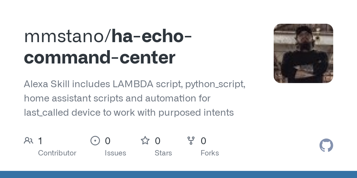

I created my own method to use the “Last Called Device”. I did it by creating a custom Amazon skill using Amazon Web Services (AWS) and Amazon’s Developer Console. In AWS, I (with immense help of ChatGPT and Grok) created a python LAMBDA script that uses a Home Assistant webhook. I also created a python_script for Home Assistant, as well as a handful of scripts, an input_text helper, a template sensor, and one master automation.
It works like this - when I invoke the custom skill with an intent using Alexa through any of my dots or shows, the LAMBDA script sends a json query to my automation via webhook. My automation then parses the json for the specific intent invoked and a device ID for the Alexa device I just used (using choose block conditions) and it fires off a script and prints the device ID to the input_text helper. The beginning of every script fires off the python_script in HA, which ties the Alexa device ID in the input_text helper to the notify speak entity of the Alexa device I last used (from the Alexa Devices integration) and prints that to the template sensor, which then my script has my Alexa device give me whatever information I programmed in the script to give me, like a laundry status, or a door status, or adding/removing an item from the Home Assistant shopping list.
All of the code is available at my repository on GitHub. The skill is built just like the Alexa Smart Home skill on Home Assistant’s website, except for this skill you have to create intents in the Alexa Developer Console (each intent requires 3 ways of asking a question). I have yet written a tutorial for it, but the code is here -
You could, instead of using all of the code, gut it and only use part of the LAMBDA script, python_script, and part of the automation to query for your last called device only.
