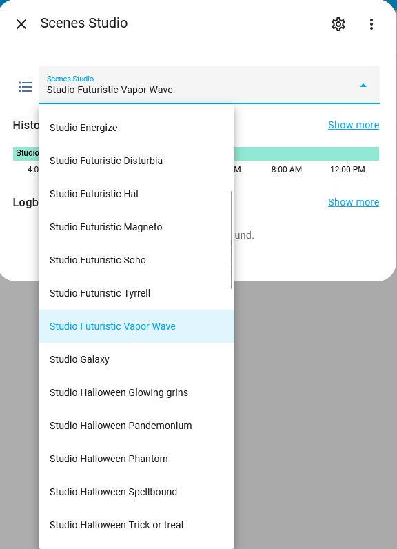

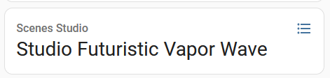

I can see the scenes in an entity card I created
Strangely, there is already one scene selected, while it is not active.

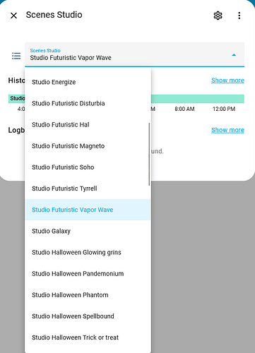

When I click I get the “properties” popup
Here I can select from the populated list, although one scene is missing. More specifically, all the scenes named scene.studio* appear while another one called scene.000_studio_off does not. I understand the listbox is populated with scenes in a given area, isn’t it?

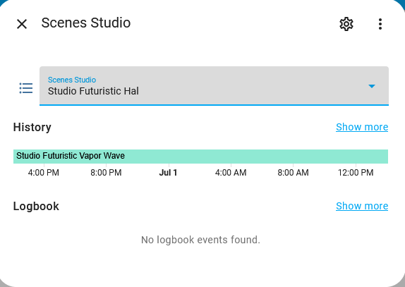

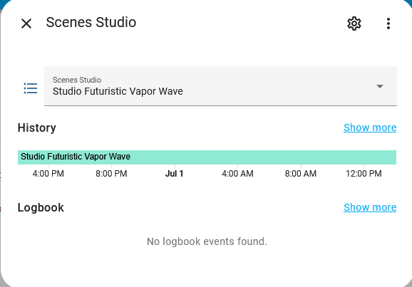

Selecting a scene (e.g., Studio Futuristic Hal) the scene is applied
But the entity card still shows the initial value (the scene that nobody selected)
Am I doing anything wrong?
In HA there is no concept of a scene being active the way you describe. A scene is active when it is in the process of applying itself, which takes mere seconds. Turning it on runs the actions in the scene, when all states are set then the scene turns off. It does not know if those devices are still in the state that the scene describes a moment later.
You have a selector to select the name of a scene, and an action that activates the scene if you pick a new name. The selector needs at least one of the values to be the current one. If there is no empty choice at the start, it just picks one (probably the first).
The problem with the current approach is you cannot pick the same scene twice in a row. So if you set a scene, someone or something else operates on the devices, the select is still pointing to the same scene. You have to pick another scene before you can pick the original one again.
