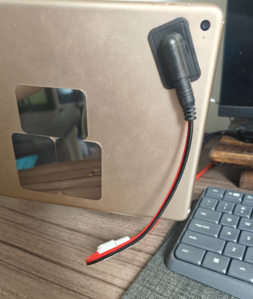

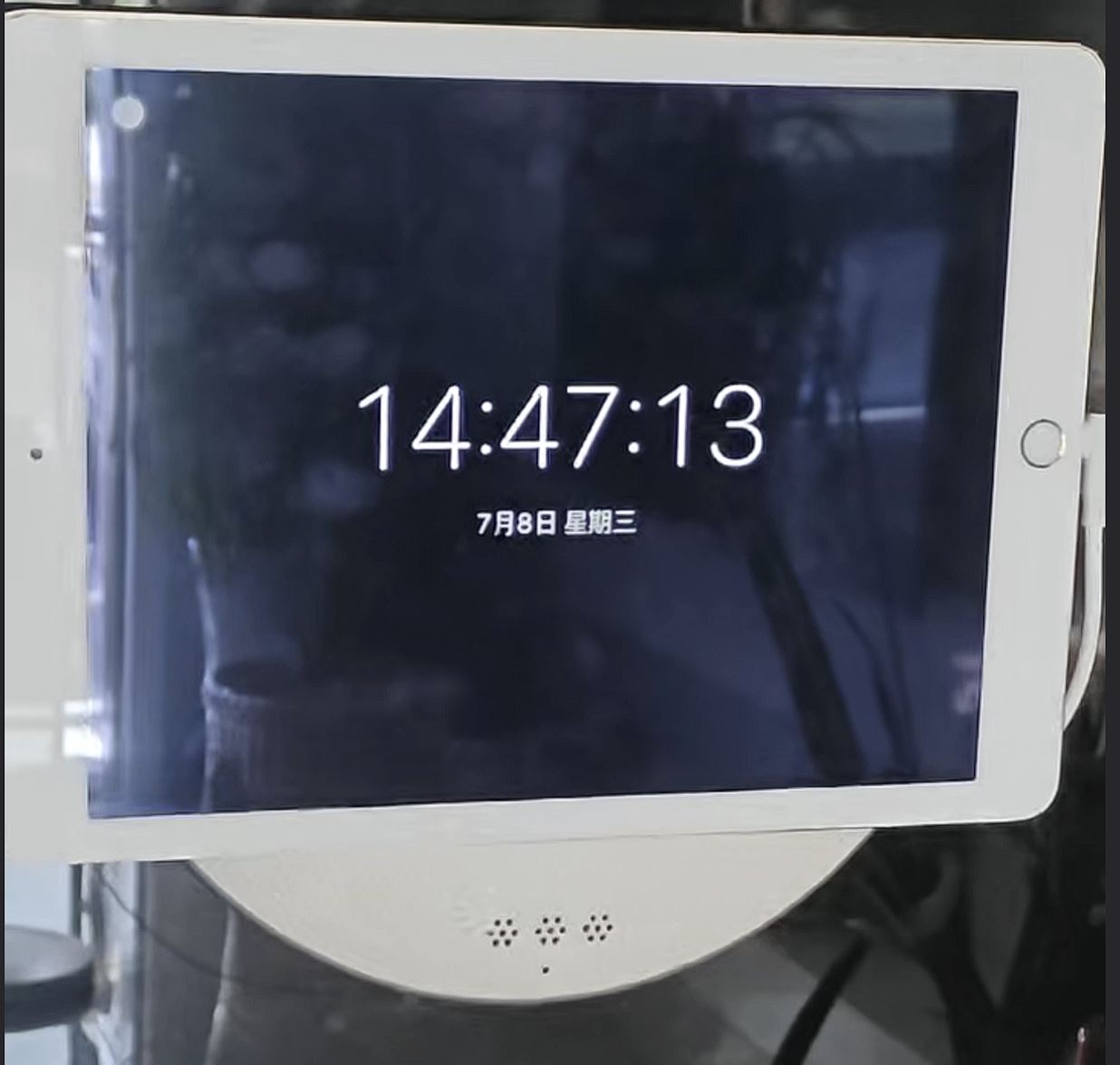

I connected the device directly to the indoor 12V access control power supply to serve as an HA monitoring screen, ensuring it stays powered on permanently without needing to be recharged. I also used a Bluetooth keyboard module—sourced from a fellow forum member—to trigger the screen to wake up when someone approaches and turn off when they leave.
iPad air2

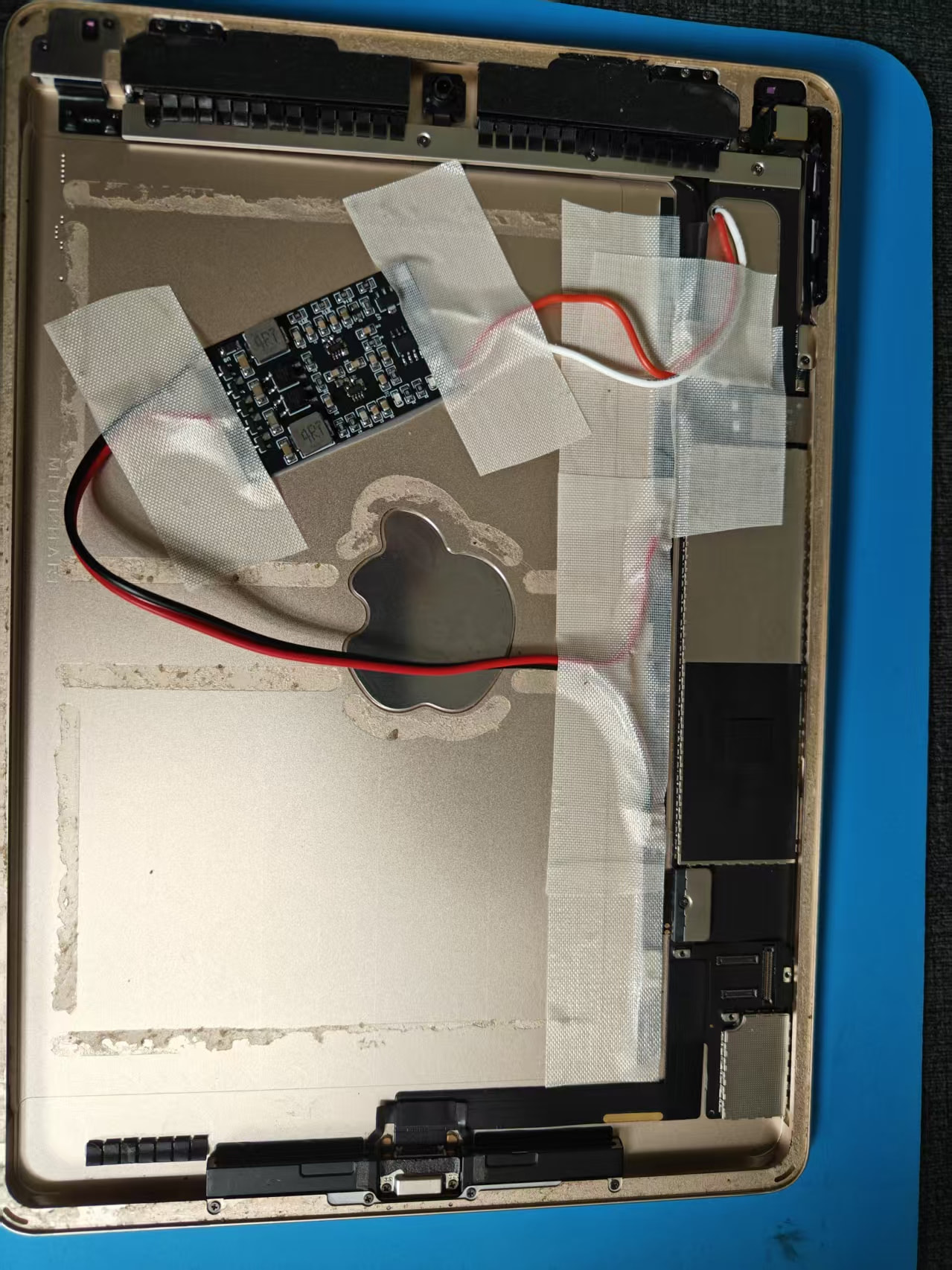

Using an iPad as a central control panel for a Home Assistant smart home setup presents a challenge: traditional iPads require battery charging, and leaving them plugged in long-term creates heat and safety concerns. To solve this, the battery can be removed and replaced with a direct power module—such as a stable ZXDN10 DC-DC step-down module (capable of outputting 4.2V and over 2A)—allowing for continuous power without worrying about battery issues. Additionally, by pairing an ESP32-C3 with a millimeter-wave radar sensor (like the LD2410B) and flashing it with Bluetooth keyboard firmware, you can enable automatic screen activation when someone approaches. This method offers virtually zero latency and works far better than triggering the screen via SMS notifications.

Yes, I initially used an iPad-based charging strategy controlled by battery levels, but over time, I found that the automation would occasionally fail due to network issues. Since I happened to have a spare iPad Air 2 lying around, I decided to try a hardware modification. I utilized a 12V power supply—which provides constant power—located right by the entryway intercom, so I no longer have to worry about charging. Furthermore, relying on the internal battery poses safety risks for a control panel that stays plugged in 24/7, as the battery can swell or bulge if it fails. Regarding the motion-activated screen wake-up feature: I originally used the iPad’s built-in notification-based wake-up method. While functional, there was a delay of a few seconds between detection and the screen turning on—a lag that detracted from the user experience. The Bluetooth keyboard firmware, on the other hand, is excellent; it offers near-zero latency and a very smooth experience.
