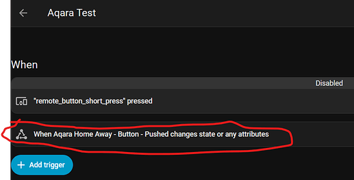

I have an Aqara mini switch and when I use it’s entity as a trigger as shown circled in red below, it causes Home Assistant to reboot. This has occurred to me several times. One time I had a TTS message as part of the action, and it just kept looping. I restarted HA to stop it.

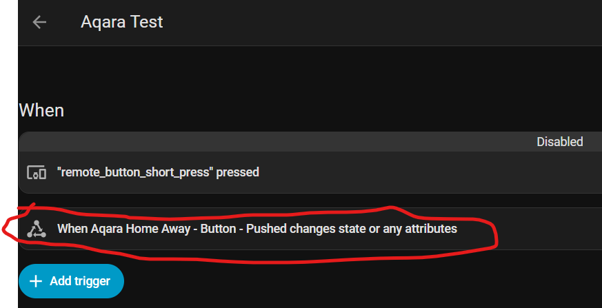

If I use the device as a trigger, it works fine as shown below. I’ve included the YAML, not much to it.
I can use the device for now, just trying to understand why this issue occurs when using the entity.

If this is your actual automation, it’s messed up.
That trigger will happen if you enable the automation. Changing the state of automations is not a normal thing, and is really only useful for turning on things seasonally or similar, not for daily operations. The state of an automation represents if the automation trigger is allowed to look for events or not, and has nothing to do with if the automation is triggered or not.
There is also there is no action, so what are the triggers for.
Beyond that, I do not recommend device_ids for automatons at all for reasons…
I am unable to use an entity for this automation for some reason. If I select the button press entity, it includes that “changes state or any attributes” for some reason. So I’m using the device and its working fine now.
