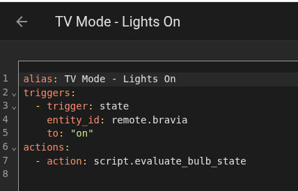

So, there is an id, but HA is not seeing it. This is what it looks like in settings->automations-> edit in yaml:
And, I am unable to edit the yaml in “settings->automations-> edit in yaml”, thus the screen grab
The only way to edit it is with Studio Code Server, or the inbuilt editor.

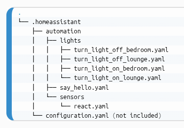

I’ve got a folder not unlike this one:
I have no early idea what a “dictionary” applies to in this context.
The goal is to be able to see the automations in the Automation tool in HA, and be able to edit it in the Edit in YAML section.
All my automation files look like the one shown above. According to the documentation, there should be no “-id: xxxxx” in any of the files.
So, which if the four options is appropriate in my use case?

I haven’t read the other posts, but I’ll just answer the question.
You cannot edit automations in the UI that are outside the automations.yam file. You can only view them.
Having this inside your configuration will allow you to edit automations in yaml or in the UI.
automation: !include automations.yaml
Using this in your configuraiton.yaml will limit you to yaml only but you can view it in the UI.
automation: !include_dir_merge_list automations/
EDIT: I read the other post. They are making the assumption that you are using automation: !include automations.yaml which you said you were not using. Meaning the advice is missing the mark. Their advice is showing you how to have automations that are managed only by yaml, and automations that are also managed by the UI, side by side but mutually exclusive. This does not mean you can organize your automations in folders while also using the UI.
