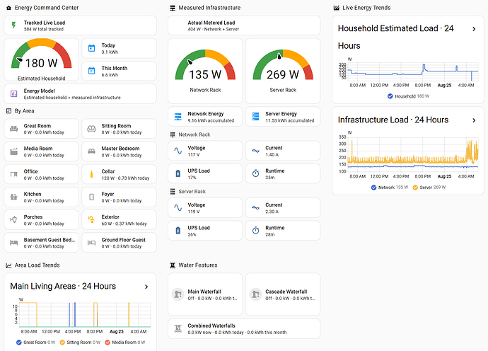

Over the past week, I’ve been reworking my Home Assistant setup from a collection of individual device controls into something that behaves more like an operating system for the house. The goal was not simply to make prettier dashboards, but to make Home Assistant surface what actually matters: how systems are supposed to behave, where energy is being used, when something deviates from normal operation, and which conditions deserve attention. That led to purpose-built dashboards and backend helpers for energy, HVAC, infrastructure, batteries, backups, water systems, robots, and outdoor equipment, culminating in a House Exception Center focused on abnormalities rather than forcing me to scan dozens of normal devices.

    We generally built and validated the underlying logic before touching the presentation layer. For HVAC energy tracking, for example, we created the helper sensors and calculations first, verified them, and only then added them to the dashboard. This made troubleshooting much easier.

    Home Assistant sees four thermostat zones in my house, but there are only three physical HVAC systems. Ground Floor and Master Bedroom share one system, so simply adding all four zone loads would double-count equipment. We modeled the physical system rather than blindly treating every HA entity as independent.
  7. Turning real-world information into telemetry
    I could give ChatGPT information that Home Assistant itself did not know: model numbers, manufacturer specifications, screenshots, and physical-system details. We used that to create additional telemetry where direct metering was unavailable, while clearly identifying calculated values as modeled or estimated rather than measured.

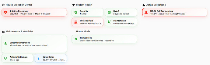

  9. Moving from status dashboards to exception dashboards
    The House Exception Center was one of the bigger changes in approach. Instead of displaying hundreds of devices that are functioning normally, it is designed to answer one question: What needs my attention right now?
  10. Debugging the design itself
    The iterative process also exposed logic problems. At one point the dashboard showed 1 Active Exception, while its category counters showed zero. We traced the discrepancy to inconsistent counting logic and corrected the design rather than simply hiding the symptom.
