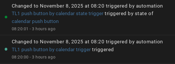

Question 2: can I get the context information directly from the entity as well? The logs of the entity show the context information too somehow:
the green dot entry shows the parent_id as state of the calendar calendar push button
the blue dot entry is missing the information that the trigger was caused by the calendar

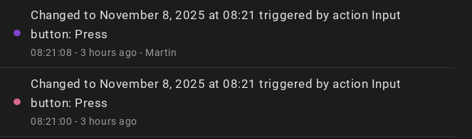

and here the log shows with purple dot my user when I click the button on the dashboard:
and pink is when the scheduler extension pushes the button with no parent_id resulting in no information where the push came from - sadly :cry:
