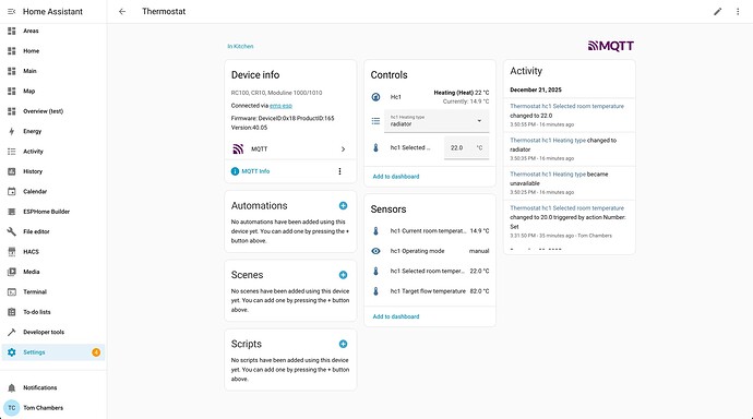

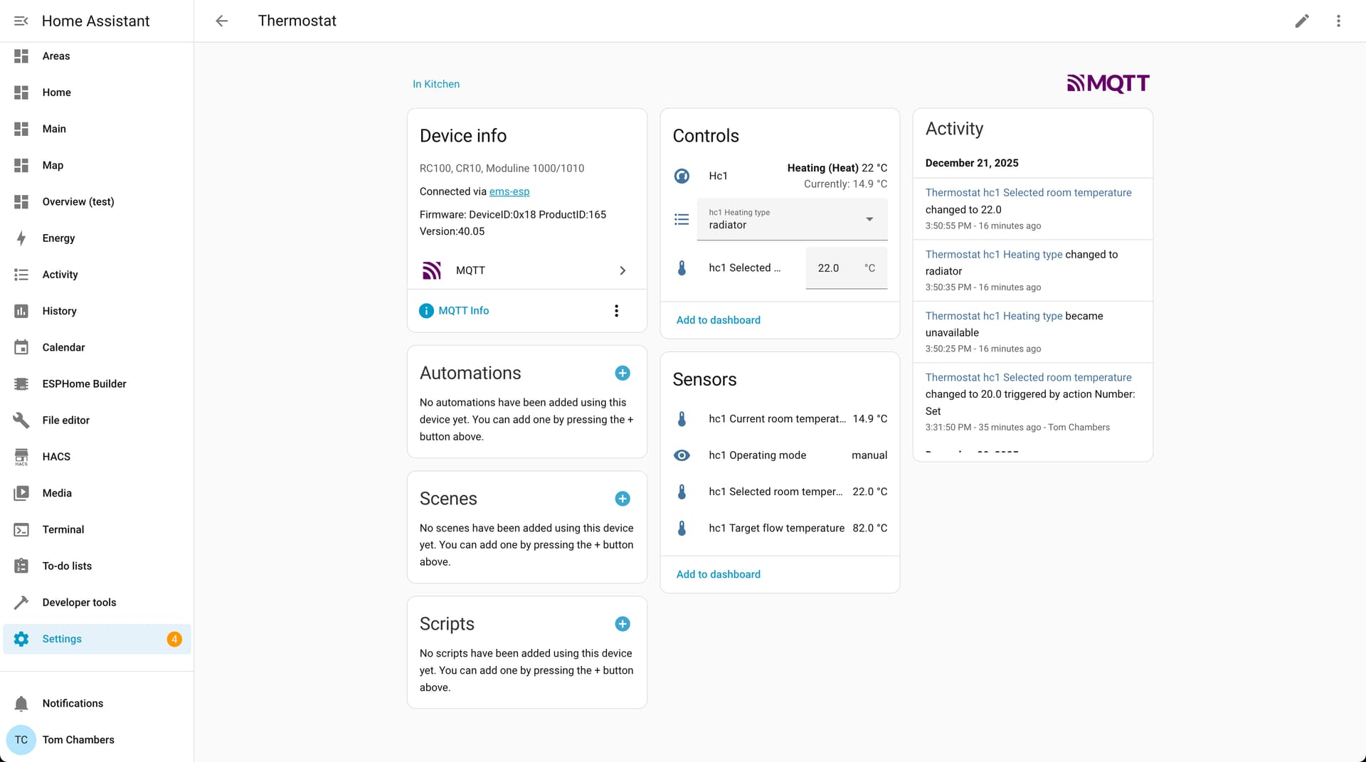

Update for anyone with similar setup
Tried easycontrol - this does NOT work as I believe it has its own encrypted communication protocol even though its wired into the EMS bus.
I bought a Worcester Bosch Greenstar Sense I wired thermostat for about £20 on ebay and wired this into the EMS terminals. I also had to remove the existing programmer module from the front of the boiler, which looks a bit odd as now theres a space there, but I have now have the full setup working.
