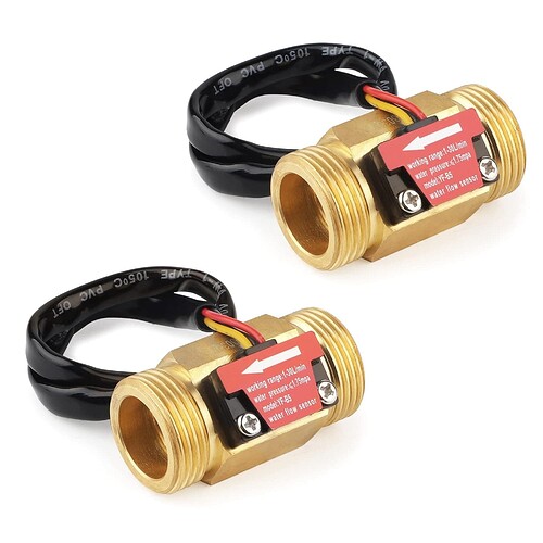

I installed the YF-B5 (F=6.68Q) on the fisrt one and another smaller (F=5Q) on the other.

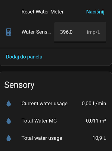

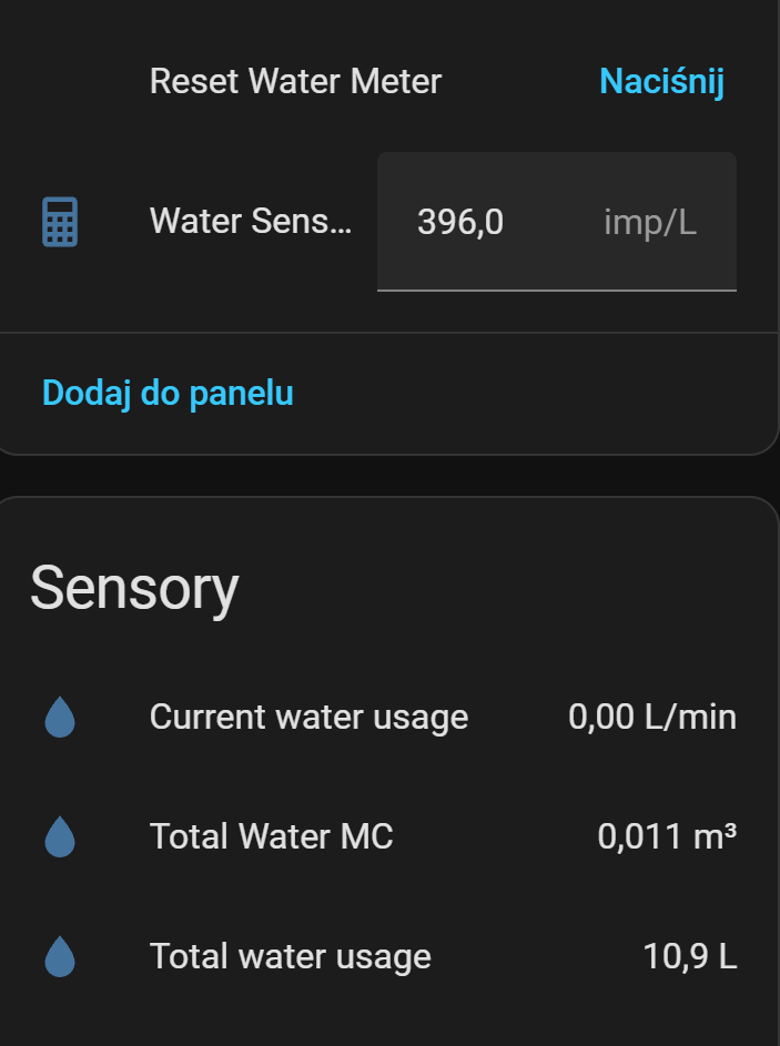

I’ve made a adjustable esp32 for diferent water flow sensors so you can adjust the flow acuracy without a nes esp32 install, and there is a reset button for testing
globals:
  - id: water_offset
    type: float
    restore_value: yes
    initial_value: '0'
  - id: k_factor
    type: float
    restore_value: yes
    initial_value: '396.0'
number:
    name: "Water Sensor K-Factor"
    icon: "mdi:calculator"
    unit_of_measurement: "imp/L"
    min_value: 30.0
    max_value: 500.0
    step: 0.1
    initial_value: 396.0
    optimistic: true
    restore_value: true
    on_value:
        - lambda: 'id(k_factor) = x;'
    name: "Reset Water Meter"
    icon: "mdi:water-reset"
          id(water_offset) = id(total_water_raw).state;
          id(total_water_l).publish_state(0);
          id(total_water_m3).publish_state(0);
  - platform: pulse_counter
    pin: GPIO34
    unit_of_measurement: 'L/min'
    name: 'Current water usage'
    update_interval: 5s
          if (id(k_factor) > 0) return (x / id(k_factor));
          else return 0;
  - platform: integration
    sensor: water_usage
    time_unit: min
    internal: true
    name: "Total Water Usage"
    unit_of_measurement: 'L'
    device_class: water
    state_class: total_increasing
    accuracy_decimals: 1
    lambda: return id(total_water_raw).state - id(water_offset);
    name: "Total Water MC"
    unit_of_measurement: 'm³'
    device_class: water
    accuracy_decimals: 3
    lambda: return (id(total_water_raw).state - id(water_offset)) / 1000.0;

I just can’t thank you enough. I’ve been going crazy over installing my water flow sensor, and fortunately found this. So far it looks alright. Let’s see if this matches my water company meter.
Regards
