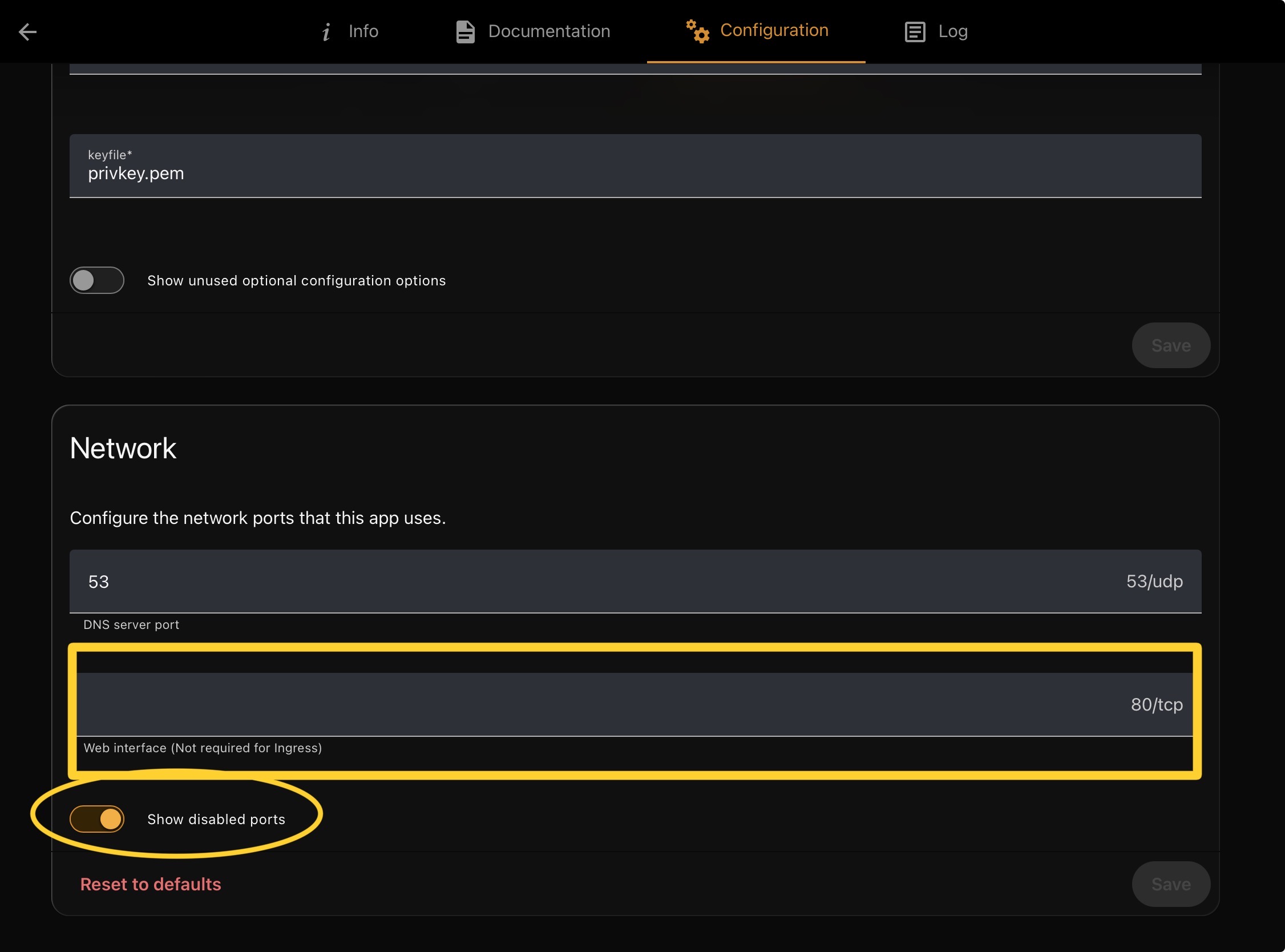

Go to the configuration of the AdGuard app, and set a web interface port in the Network settings. (Note: this likely exposes it to your whole .178 LAN).
Then,point it the iframe at http://192.168.178.14:<PORTNUMBER>
That in theory should work, as long as AdGuard doesn't use CSP/X-Frame Options. If it does, your iframe will never load.
Picture for reference:
