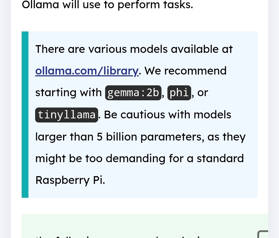

Let it be the case I upgrade my Raspberry to the most powerful version available on the market. I have been reading about them being able to at least, run small models (which I would train to do specific tasks) rather than using bigger or the latest models.
For example, I have been reading about this here: Adding Ollama to the Raspberry
If I have enough space for both HA and Ollama, and its powerful enough to run both at the same time (due to really small models) is it actually unsuported?
Has anyone tried it?
This… From your own link…
Both at the same time isn’t gonna happen… Even if you get the hottest pi you can find rn.
Those models won’t do for anything except base utility. They won’t hold enough context to use tools, you might get one to do small utility jobs like tiny summaries or a small single use vision job that’s all. You might get it to drive a camera for a single use job… Maybe.
So then you’re taking one of the most expensive per Cpu cycle ways to run (an un accelerated pi) with the least effect. So yes you can RUN a tiny model but tiny model then takes the entire box the what? It’s not gonna get you where you want to be. Save the money for a future gpu.
I don’t mean to sound harsh but people need to have realistic expectations. Pi aren’t suitable for LLM work in most cases. It ends in pain in hobby land.
