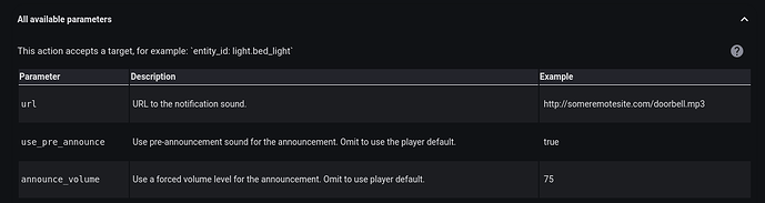

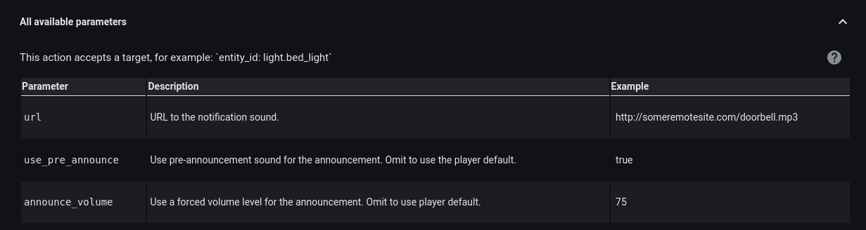

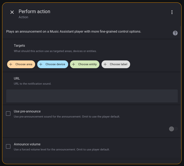

The play_announcement action is not a text-to-speach generating action and announcement_text is not a valid configuration variable for that action. This action plays an audio file that is accessible via the URL you provide. All of it’s valid configuration data variables can be seen in the Action Tool:
or the Automation Editor:
or the Music Assistant Docs for it’s Home Assistant integration:
or the Home Assistant docs for the Music Assistant integration:

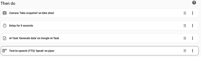

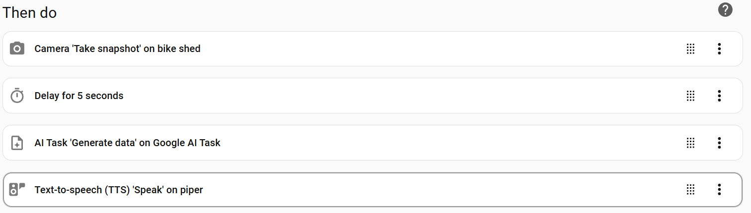

Ok I got it working with tts.speak The only downside being it doesn’t pause the music and resume as Music assistant does. The key bit I couldn’t easily see elsewhere was how to access the returned text.
message: “{{ response[‘data’] }}”
action: tts.speak
metadata: {}
  cache: true
  media_player_entity_id: media_player.mopidy_http_server_on_portadyne_6680
  message: "{{ response['data'] }}"
  entity_id: tts.piper
The full automation looks like this. It’s been done before. The difference now is I needed to change the ai to use the new ai task. The John Mills voice is quite verbose
