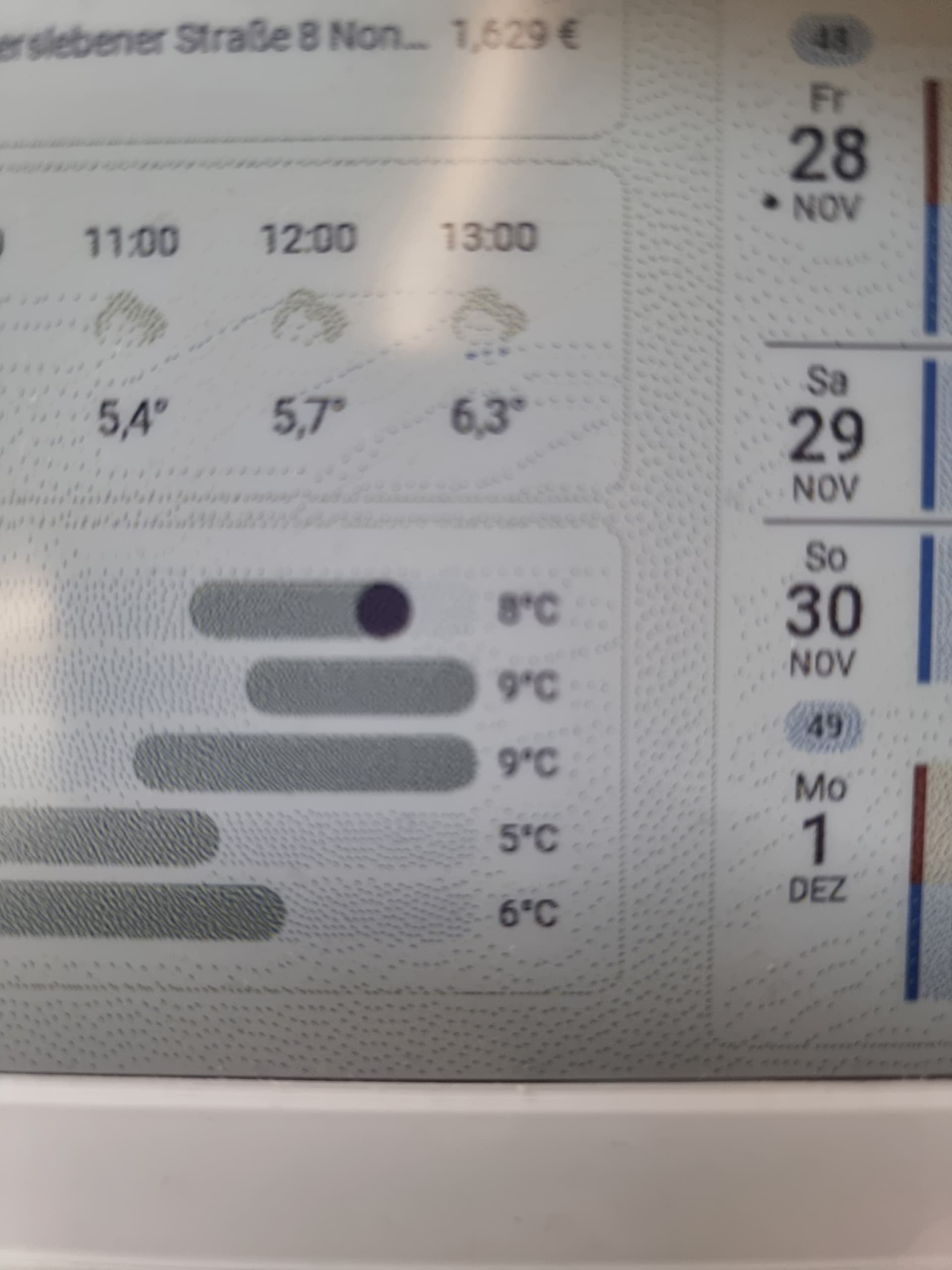

Hello, I’m using the Seed Studio e-ink display e1002 together with Puppet for Home Assistant to display my dashboard on the screen. I’ve managed to get everything working so far, but unfortunately the display quality isn’t very good and there are many artifacts on the display. I’ve attached a photo. Can anyone tell me how to make this look better? Can I improve it with a Puppet setting or in some other way? Thanks a lot.
Does your theme have a non white background?
Make sure you use a theme that is suitable with puppet and e-ink. Like the one linked in the description of the puppet add-on.
I got a similar result with any dithering option turned on. Removing the dithering cleans up the image.
This is assuming you are using the current version of the add-on and that you have specified &colors.
