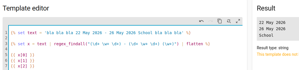

Copy-paste this into the Template Editor and experiment with it.
{% set text = 'bla bla bla 22 May 2026 - 26 May 2026 School bla bla bla' %}
{% set x = text | regex_findall("(\d+ \w+ \d+) - (\d+ \w+ \d+) (\w+)") | flatten %}
{{ x[0] }}
{{ x[1] }}
{{ x[2] }}
If it meets your requirements, you can use it like this:
variables:
  x: >
    {{ trigger.event.data["text"]
      | flatten }}
  booking_dates:
    start: "{{ x[0] }}"
    end: "{{ x[1] }}"
  location: "{{ x[2] }}"
