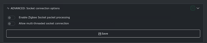

  • Sometimes, if the connection is going down too often, we enable the “allow multi-threaded socket connection” under the Z2M and ZHA menu:
    I don’t know exactly what it does, but we’ve read somewhere that it solves this issue when it happens frequently and it’d worked for us.
These strategies made our connections much more stable. We have dozens of them installed all around the country we work on and we haven’t had any issues that required us to have physical access to the coordinators.
