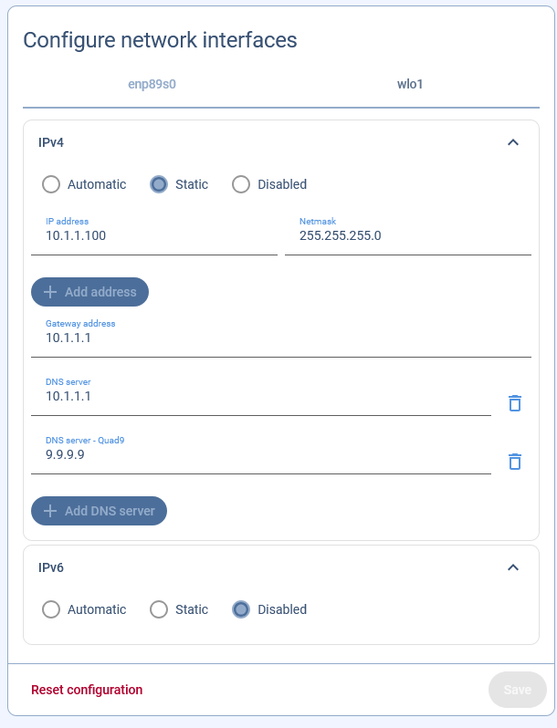

I have been using a static IPv4 address the entire time. I did notice today that IPv6 was enabled, but I have never used it, and I actually would have expected I would have previously turned this off. WiFi is currently disabled as it should be in my environment.

Unless you’re using Matter/Thread, try disabling IPv6 & see if the errors go away
Thanks… I have disabled the IPv6 and am letting it run. No recurrence as of yet, but I will need to let it go at least another few hours because some of the intervals were on the longer side in between entries.

I disabled IPv6 at the OS level on the adapter and restarted. So far, I haven’t see the error re-appear in over four hours. I’ll check it again tomorrow to see if it comes back or not.
