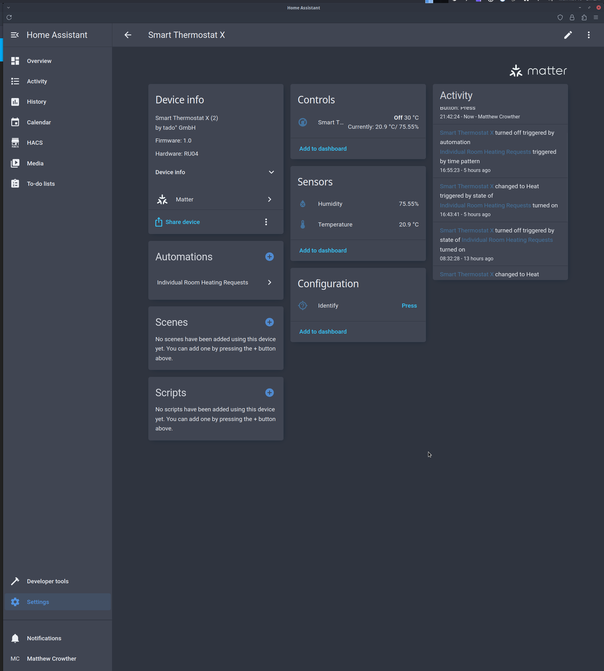

I own a wired Smart Thermostat X. OpenTherm seems to be something that isn’t exposed via Matter, at least with the factory un-updated firmware. I’ve never connected mine to the Tado system, so have never had an update.
This is what you get. Basic thermostat, with two states (Off/Heat). Humidity sensor. Temperature sensor. OpenTherm is not an option/there’s nothing you can put in that OpenTherm could realistically use for its intelligence (other than difference between set temperature and current mind). Having said that, my boiler is eBus rather than OpenTherm, so OpenTherm is not connected.
I bought it on the basis of wanting a battery powered dry contact relay. It does that. It is good for that (and expensive for that - I sense better options may have been available if I’d experimented - eg. drawing the power on the dry contacts to run something). As a Smart Device, making any decisions or thinking of its own; go elsewhere (or run it through the Tado ecosystem; although then it’s not making decisions on its own, so point stands).
In my house it runs in one of two settings (controlled entirely by Home Assistant) - Heat 30C and off, dependant on where a set of helper thermostats and helper switches attached to said thermostats are positioned (there’s another layer of automations controlling these).

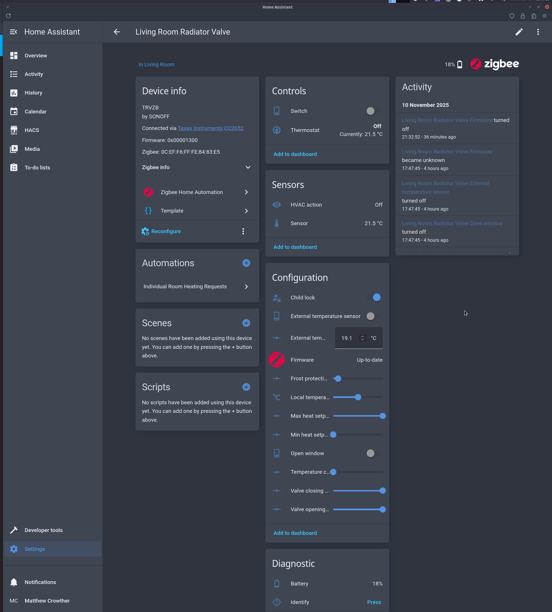

Smart Zigbee TVRs (Sonoff TVR2, which are probably the most affordable out there) are also part of the various automations I set up (ie. if one of the helper switches on, the relevant TVR opens, 20 seconds later the Tado X relay opens - boiler was making some nasty noises when all TVRs were closed and it was asked to fire up). These are criticised for having two states of “open” and “closed”, but it is possible to automate/dynamically set the level of closure/the level it is open at at any specific time (I think this came with a firmware update rather than being there from day 0). You just need to use an automation to set the logic (ie. create a template sensor, do some maths with sensors you have access to generate a value between 0 and 100, have an automation that copies the value into the respective number field on the TVR).
I’ve found TVRs to be awful for controlling room temperature - these ones at least get hot when the radiator gets hot and would trip it off too soon. I use some basic (Sonoff again) humidity/temperature sensors that are sufficiently distant away from the radiator to actually provide the sensor data to the helper thermostats. You can have an automation that copies and pastes the value from the external sensor to the Sonoffs (at least, no idea about the Tado stuff).

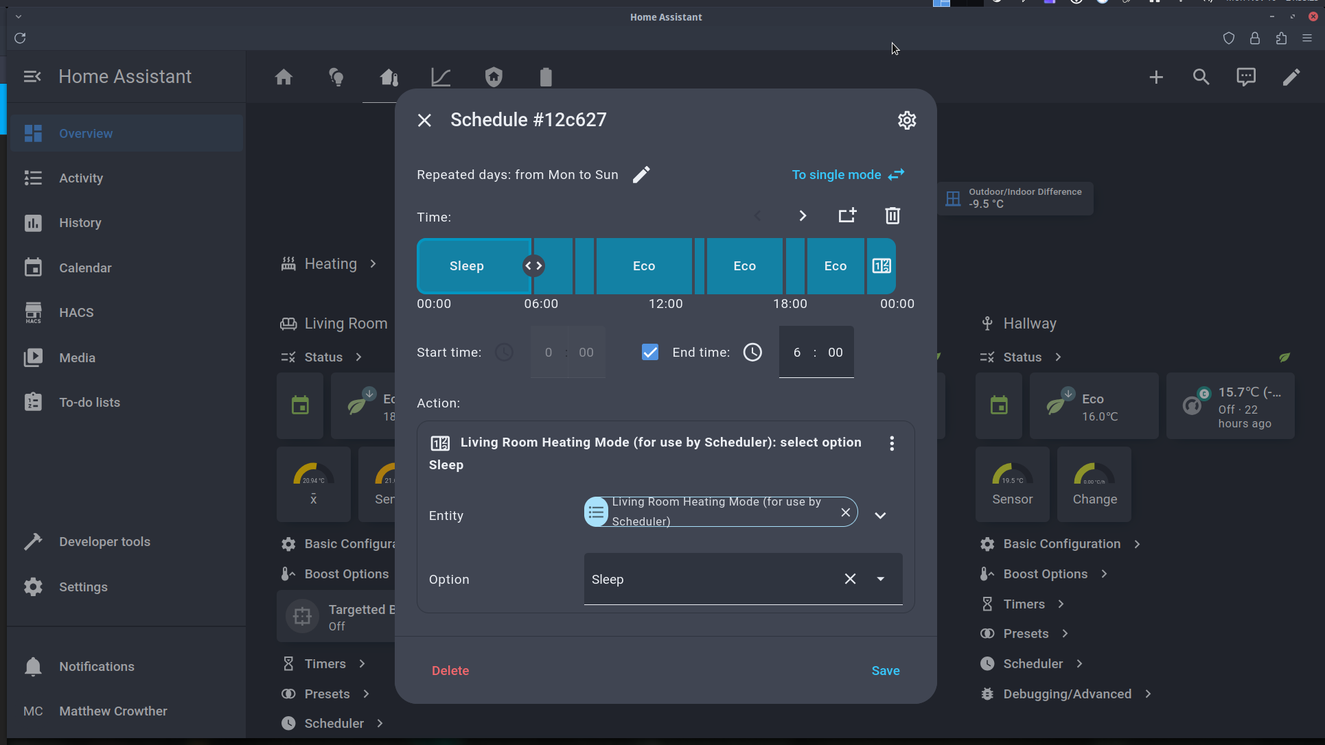

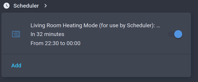

Scheduler card and Scheduler component (co-dependencies; in HACS) are what I use for scheduling (combined with a drop-down helper - I guess this isn’t essential, could have the scheduler take control of a helper thermostat and set a specific value). The card itself is basic. The options when you click on the card are fairly intuitive.
It works. It’s paired to automations so when it changes it sets the virtual thermostats accordingly (which then use the data inputted into them to determine if they should request the Tado X opens its relay and/or if the TVR valves should open).
The thermostat, is, however, otherwise useless. I did initially program something in so I meddled with either the TVRs or the thermostat it would request adjustments to the room temperature, but this was something I removed for simplicity (possibly could make it work now, but it was challenging and this is the most complex automation stack I’ve ever built). If I ever do set the TVRs etc. to something, Home Assistant will snap it back pretty much immediately.
There are blueprints that Home Assistant can use to control heating more complexly, but I found a system of helpers to work most effectively (and I could design it myself, to meet my expectations).

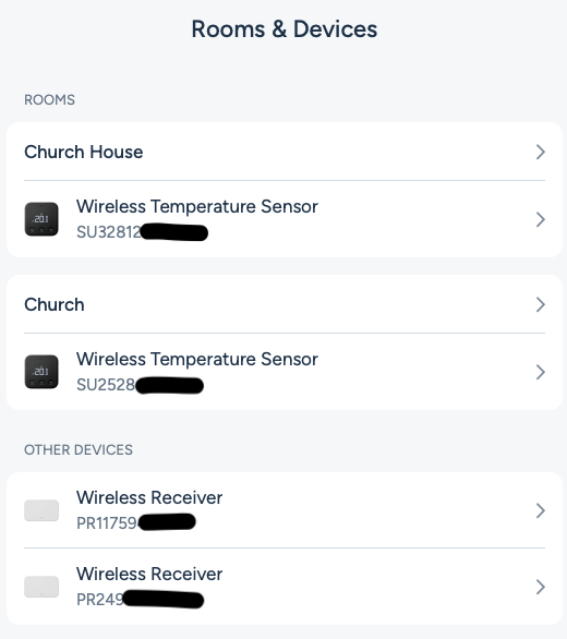

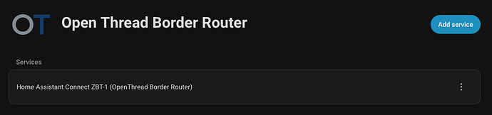

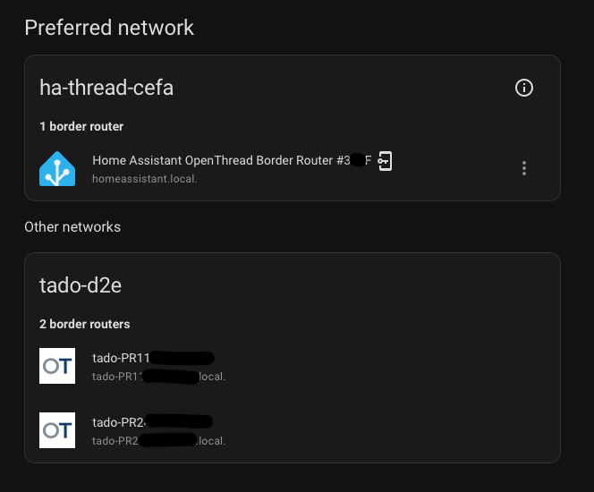

Could anyone please help with my setup? I have two tado x systems acting alone in isolation, each with a Tado X wireless thermostat. As far as I can tell I have everything setup correctly on HA with a ZBT-1 connect installed and set up to use ‘thread’ with OTBR also installed on HA. Screen shots below.
Using the Tado app and selecting the option for ‘devices in use on other controller’ and ‘matter linking’ which provides a matter code, I cannot get a connection. The icon rotates for several minutes then times out.
All devices are within a meter of each other but I just don’t get any kind of response that communication between HA and Tado is taking place.
Thanks.
Could somebody please confirm that I have the matter setup correct, even if the Tado part is not known. Thanks.
